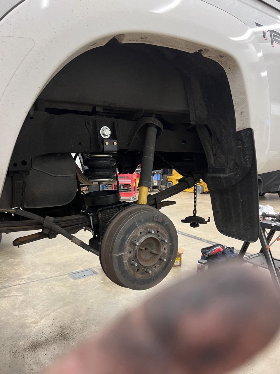

    Well I just installed the ride rite air bags. I hope I can get used to it (stiff AF) even with min of 5 psi rear is 2 inches lifted . I’ll give it some time to settle if that doesn’t do it I might loosen lower bracket bolts and retighten when truck is on ground. I tightened them when suspension was full droop maybe it will settle . upload_2023-1-8_11-7-26.jpg

    Well , no way I was going to get used to terrible ride and have to deal with constant air pressure monitoring and maintenance so I pulled bags and received refund. I have summo springs in now , better than air bags but added a lot of stiffness. I’m considering cutting them down but then I would loose the total loss of body roll which I love . I guess there is no perfect answer?
