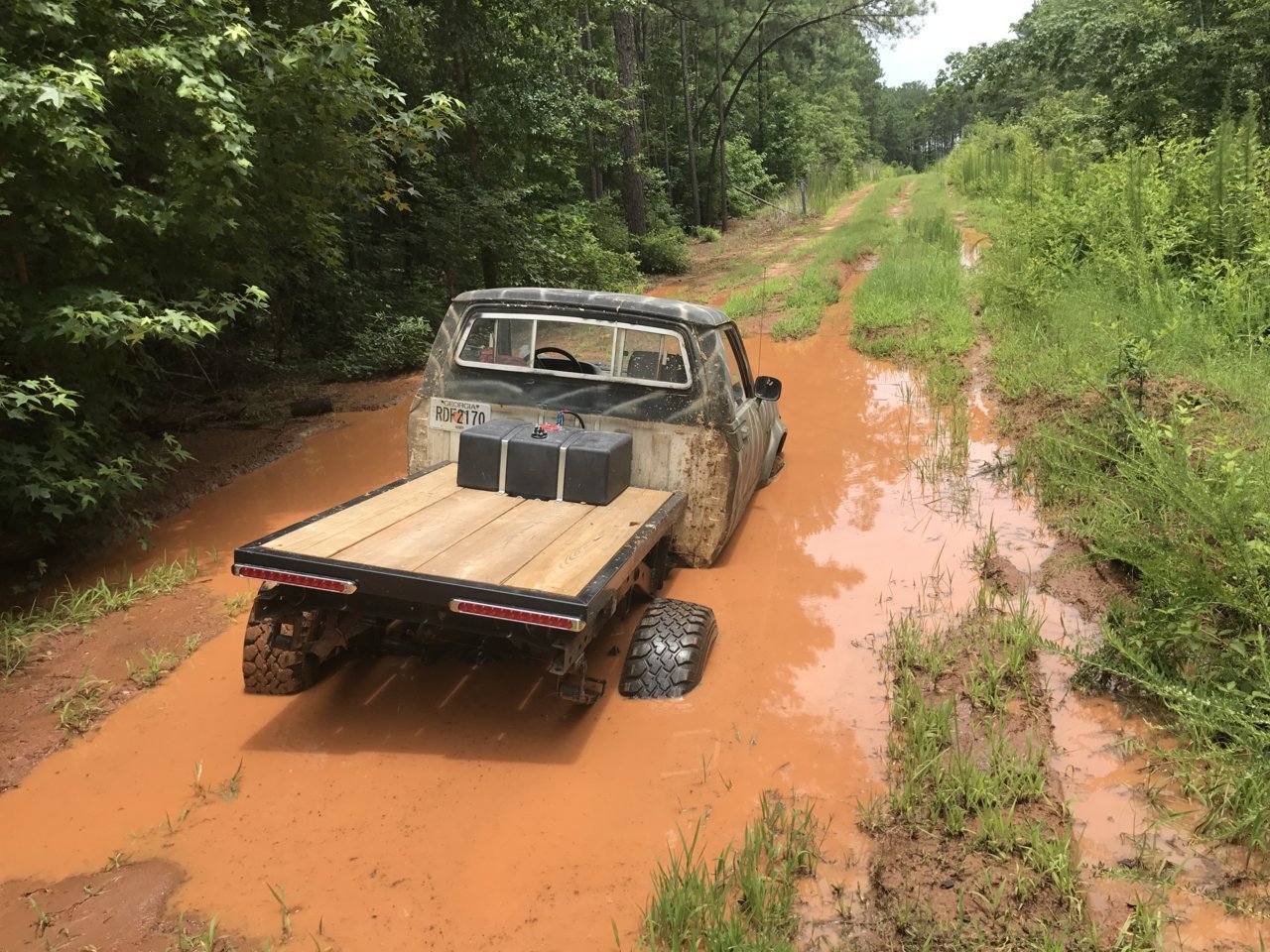

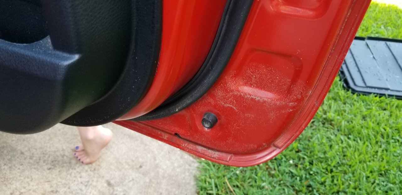

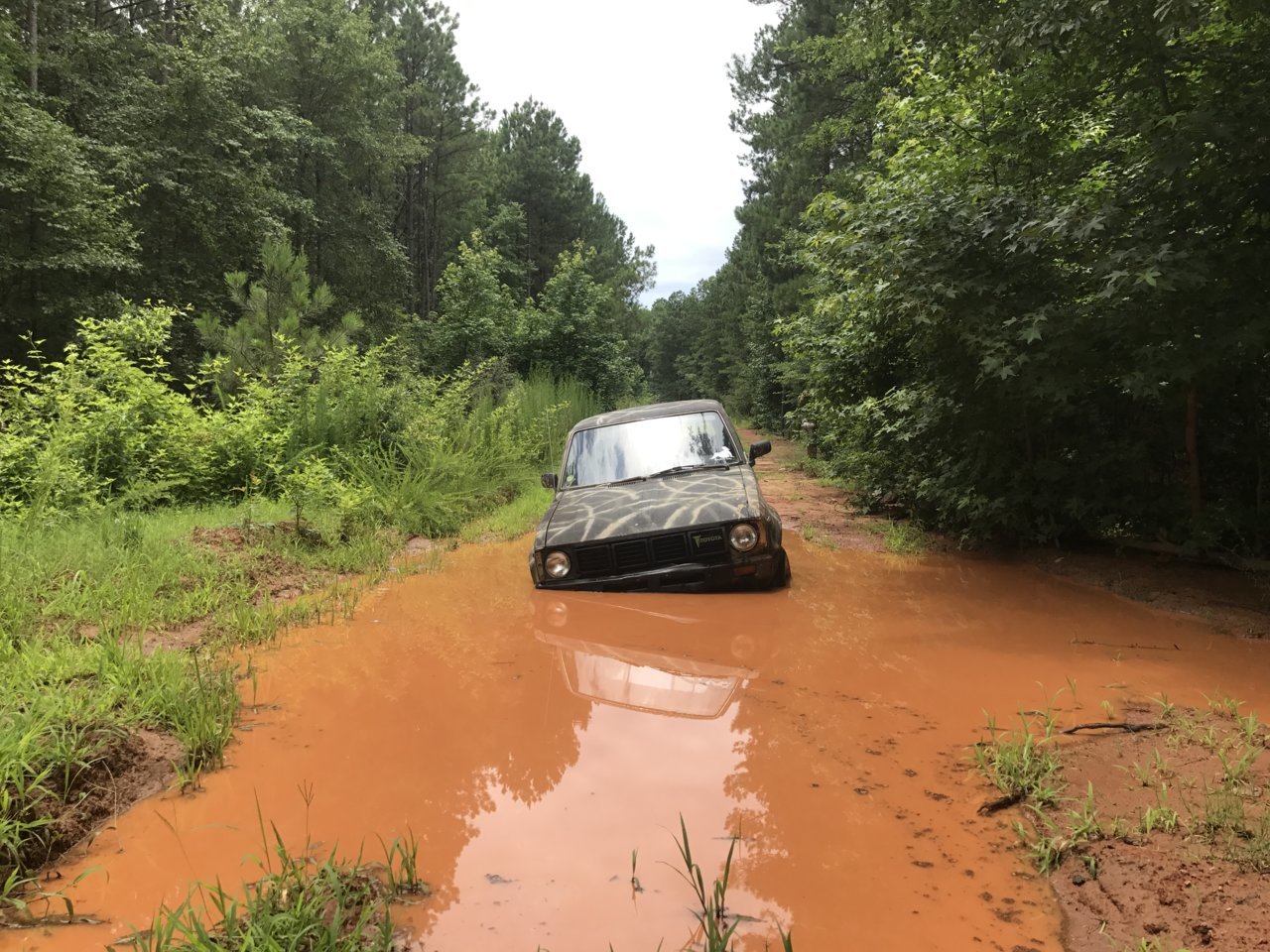

    Just fluid film them . Swapping out springs doesn't work to well either . My dakars did it too after about a month . Fluid film did the trick . Did the whole undercarriage as well but that was after the beach and brackish water trips with it up to the door weather strips. I love this thing.
    Fyi no wet carpet.
