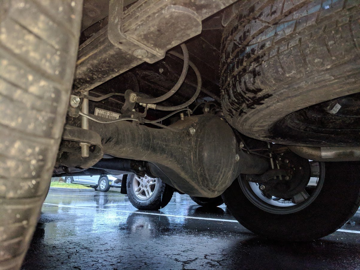

    Me! In the rain for TW's sake.

    FTFY:
    Also, track bars feel like shit, IMHO. I can feel the rear being pulled left and right when you go over bigger whoops with them.
    Leaf springs don't need track bars as they have a lot of lateral stiffness.

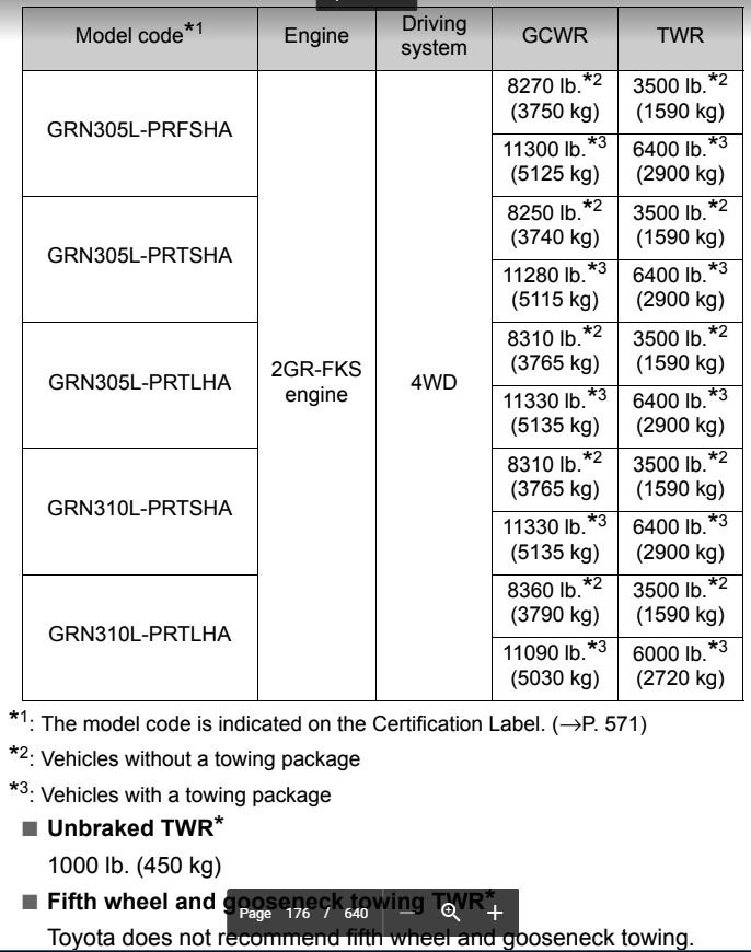

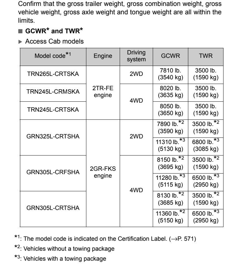

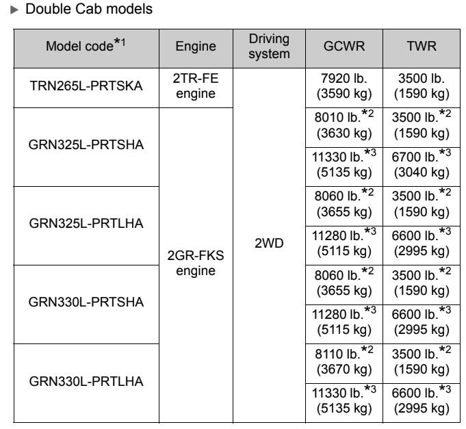

    Here are the Model Numbers for 2017:
    Looking at that leaf pack, could GRN225 be the 2nd Gen Xtreme?
