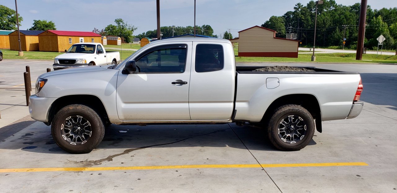

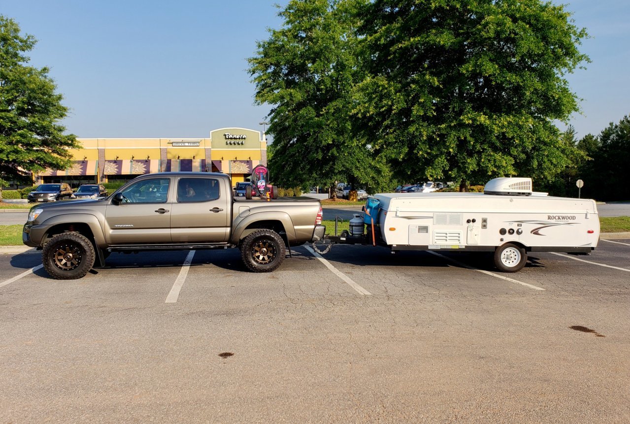

    I have had nothing but satisfacton with the Ride-rites with the Daystar cradles (see link). Without the cradles, you can't get full extension or lift the truck by the frame.
    A heavier leaf pack, if you are not always loaded, rides rougher. With the bags, you deflate them when not needed, and you never know they are there. OBA is overkill for them unless you are up and down every day. Less than a minute each with a bike pump and gauge is all you need. I have my valves each side of the tag. Keep the plumbing sperate. There's a reason for two valves.
    Daystar, Air Bag Cradle designed for full suspension travel, Fits All 6" diameter convoluted Air Bags, fits any full size of half ton truck, 2/4WD, KU09140BK, Made in America
    About a ton of gravel. 30# in the bags. (5 lugger)
    About 350# on the tongue. 15# in the bags. May could do less.
