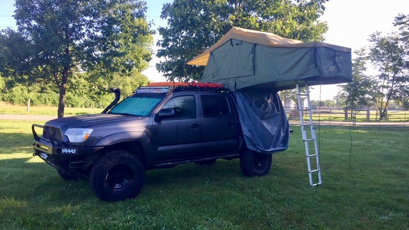

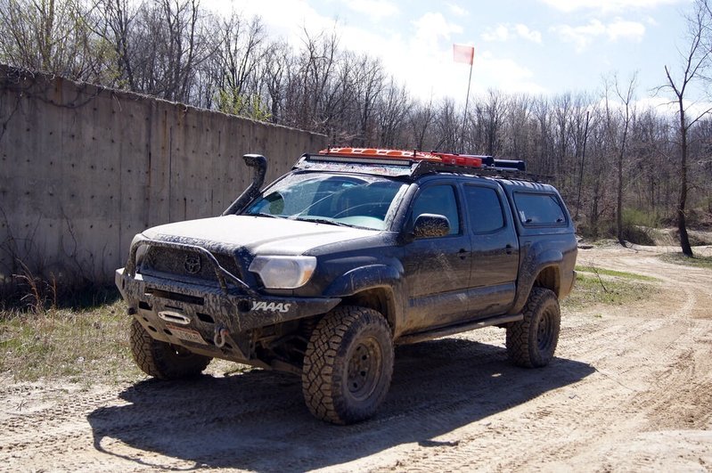

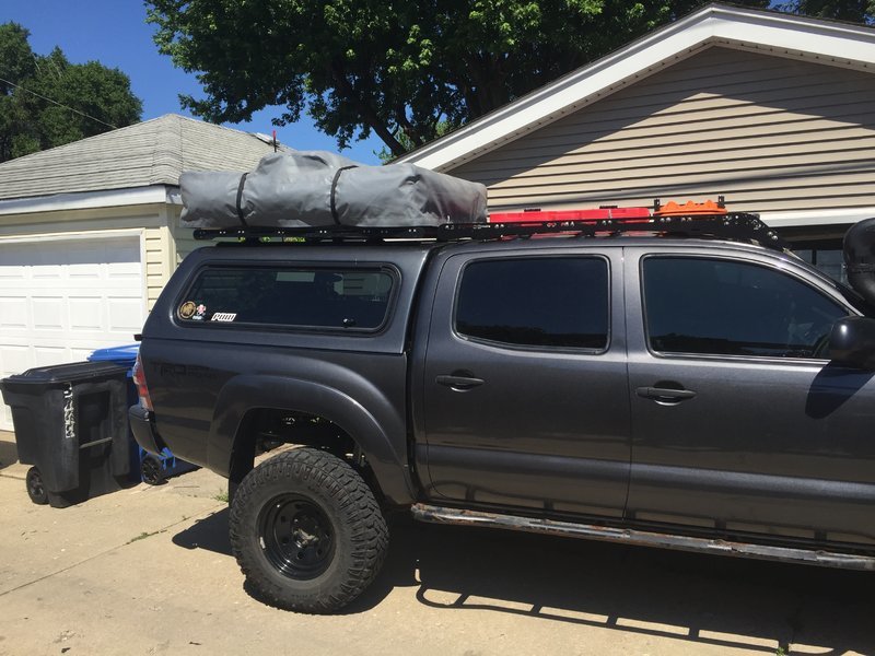

    I installed a single 2" AAL and loaded up my family's toon once and it squatted and rode like garbage before I finally swapped in a full Dakar leaf pack with D29XL AAL and it hauls loads MUCH better without bottoming out.
    I now have the shackle flip and it added some height to the rear too. The droop is handy in offroad situations. Love the look and the ride now:

    Sorry it was dark when I got home from work. I am running OME 885 coils and 1/2" plate spacer in the front with Lightracing UCAs. Dakar leaf pack with D29xl AAL in the rear with ubolt flip.
    Actually very close to geekhouse's! He has the shackle flip which I would love to do just need to find the time.
