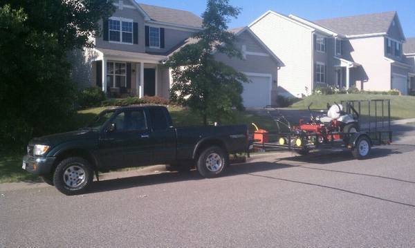

    My leafs have no arch left in them and my shocks are shot too. I pull a mowing trailer that weighs around 3000 pounds loaded. When I pull the trailer, it rides like shit. It almost gives me a headache its so bumpy. I was planning on going with OME nitrochargers for the rear to match my front nitros/OME springs, but I am unsure about what I should do for leafs. Im looking for something that will give me around 2" of lift total to match the front. I need something that will ride nice with the load I pull multiple times a week, but also ride nice without a load. Any suggestions? Toyota leafs with aal? Dakar?

    Here is what I pull
