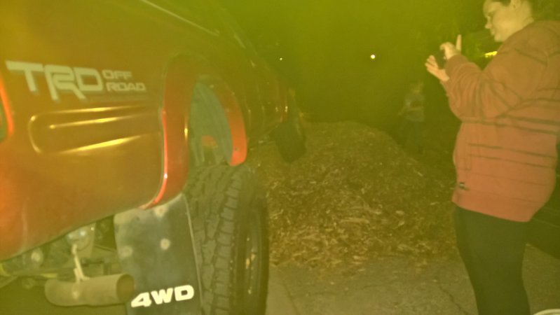

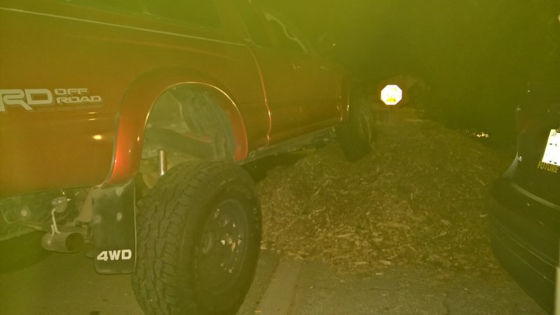

    I like my OMEs. But if you're going for serious flex, Chevy 63s. But that requires cutting and welding. The OMEs bolt right in. Here's my OME flex
    OMEs can flex more too, you have to contact OME, they'll tell you to take out a leaf or two, but I left all my leafs in because I tow a cargo trailer with dirbikes and quads
