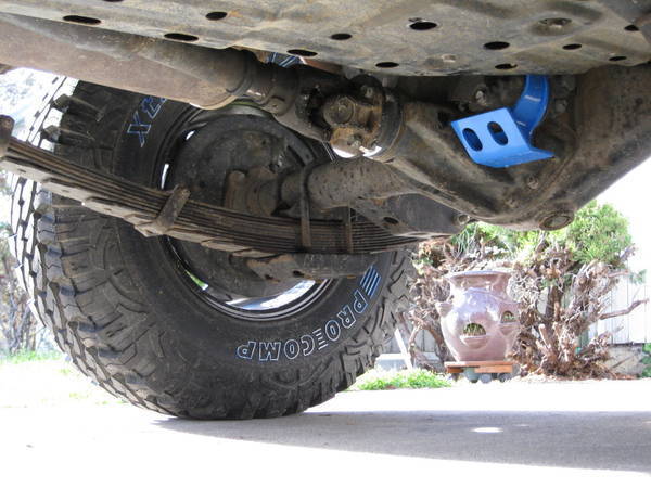

    Hit up the guys in the LT thread, I'm sure some of them do slower stuff at times and may have some feedback?? I know your flex would be crazy.....I'm in the same situation as you man!

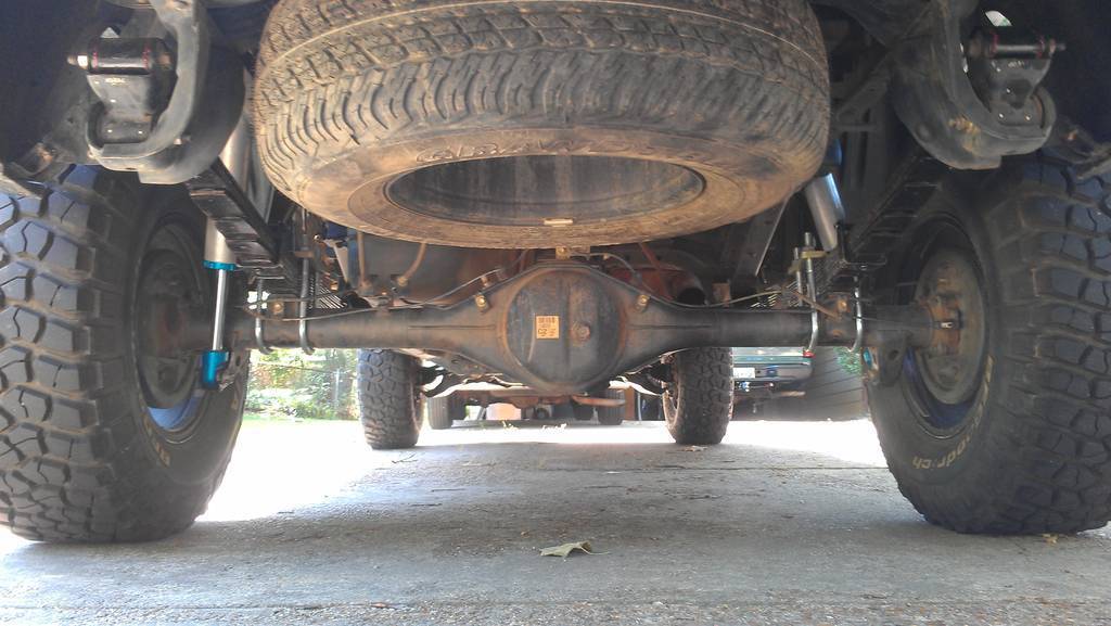

    about 9", a little longer then stock but not quite 10"
    and i agree with yall Matt and Doug about them not hanging "that" much lower but i have seen in person numerous times of people with sua setups getting hung up on something because of the extra 4" the springs hang down. And i have never seen someone get hung up because of the stock shock mounting location. The toyota shock mounting spots, compared to say a chevy, are tucked very close to the wheel and out of the way pretty good.

    I love that pic from AP! If the icon 2.5's are anything like their front coilovers, they will be soooo bad ass back there!
