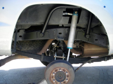

    love the idea dude!

    That's badass Landon! Did u bend that hoop urself? Im gonna try this as soon as I get a bender

    Landon
    Fallbrook
    Sure did, it's 1 3/4" .120 DOM

    U remember any dimensions on it? And did u use tha stock lower mounting position?

    No and no ha. Built it to clear the frame and the tire and use the whole shock

    Nice! And thats about tha clearence ur ever gonna get too! Hell yeah

    Looks good man you happy with the performance? My idea, while similar in theory is a bit different in design. I don't know if what I am planning is going to work in reality and if not will fall back to a basic hoop design. At any rate thats basically the set-up I'm shooting for. All Pro Exp. Pack on yours? 12'' shock? Did you tie the hoops together with a cross bar or are they stand alone?

    Yeah expos, handles amazing, the valving is dead on. Now the front can't keep up and that has a fox 2.5 internal bypass and fox bump.

    Ya, curious on your valving choice since the springs are pretty firm.....?

    They are valved pretty stiff on the compression side, had Doug at mirage do the valving. These springs are shockingly flexible and soft for how much weight they can hold. Very impressed with them

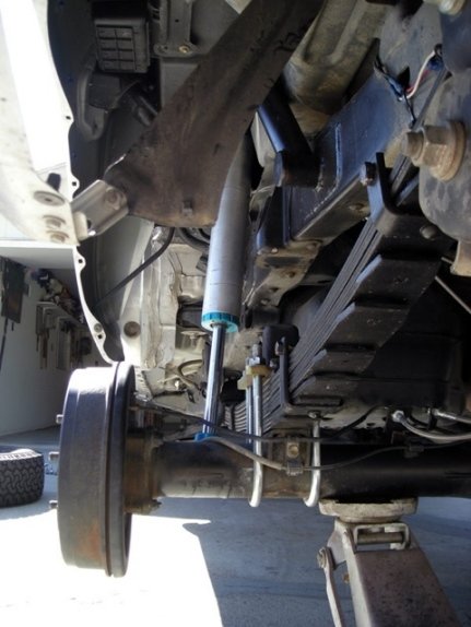

    What about this man? I know you have some ideas, lol!
    or remove shock and cycle with the springs on? main concern is what to use to jack the side (under tire and axel) and the stability of the other side!

    The best way to cycle the travel of a leaf spring set up is to take the spring pack apart and bolt in only the main spring then let the nitrogen out of the shock and cycle it till the shock mounting points are right where you want them

    In theory I could assemble everything and measure at ride height, then subtract the distance until the bump would hit? That would give me my compressed length and I already know the shock compresses to 16.35! Since they're not vertical there is some room for error though?

    Yes there is, also make sure to factor in the bump compressing
