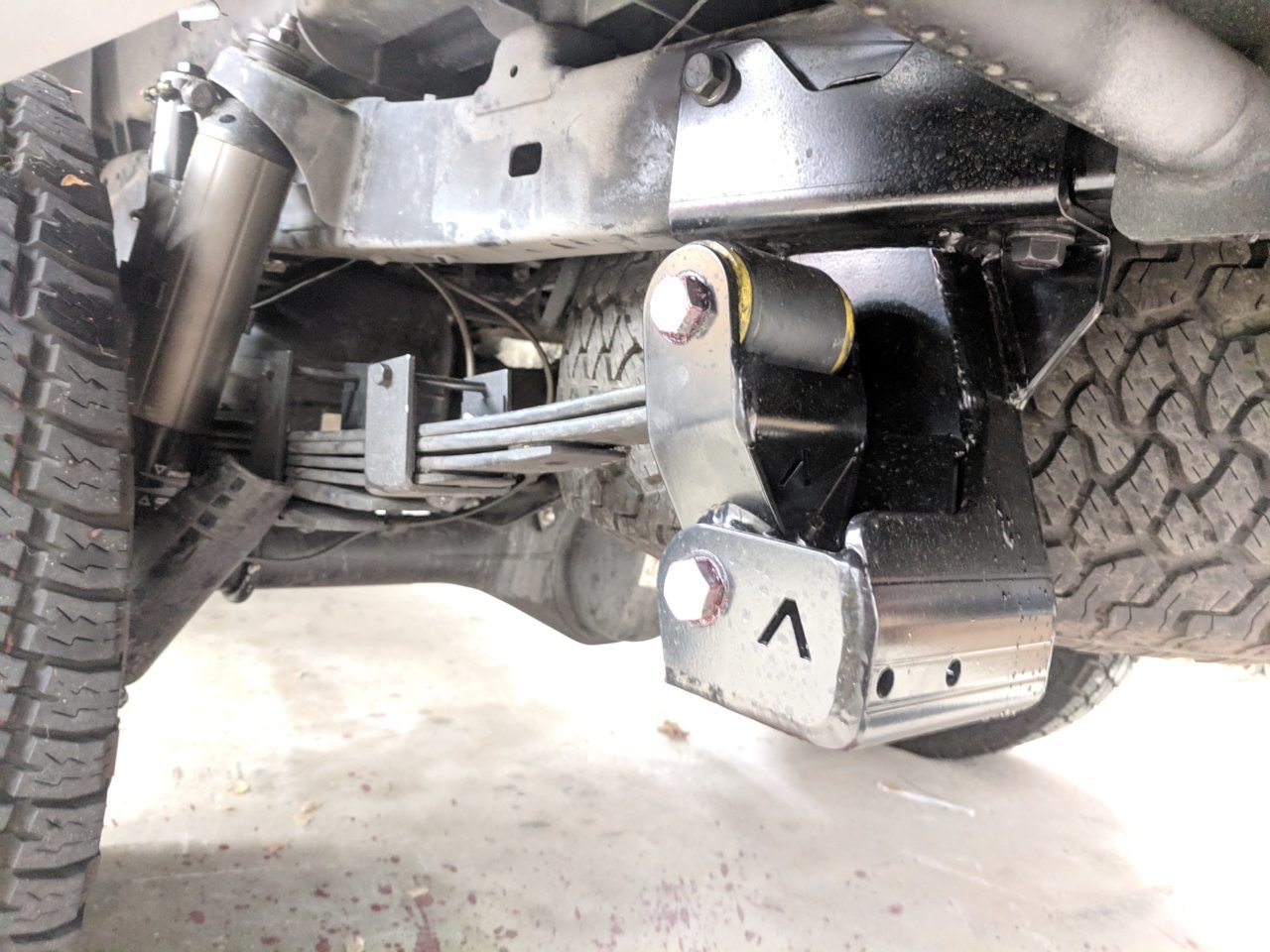

    The stock shackles are mounted in brackets that hang below the frame rails. I upgraded mine and to the archive but they "hang" low reducing ground clearance compared to the flipped shackle mount from JD that is mounted outside the frame so when the leaf is compressed, everything is tucked away, whereas the stock or aftermarket hangers don't move. The archive hangers and the cross bar was a HUGE improvement over stock but its not the best solution for clearance or travel. It really is a whole other level with the SUA. I would recommenced the JD rear leaf setup and shock relocate but steady your credit card because shock ordering is a long wait and will be for the foreseeable future.
    edit: the added benefit here of the shackle is to allow the leaf pack to move with the axle droop with a smoother spring rate at compression.
