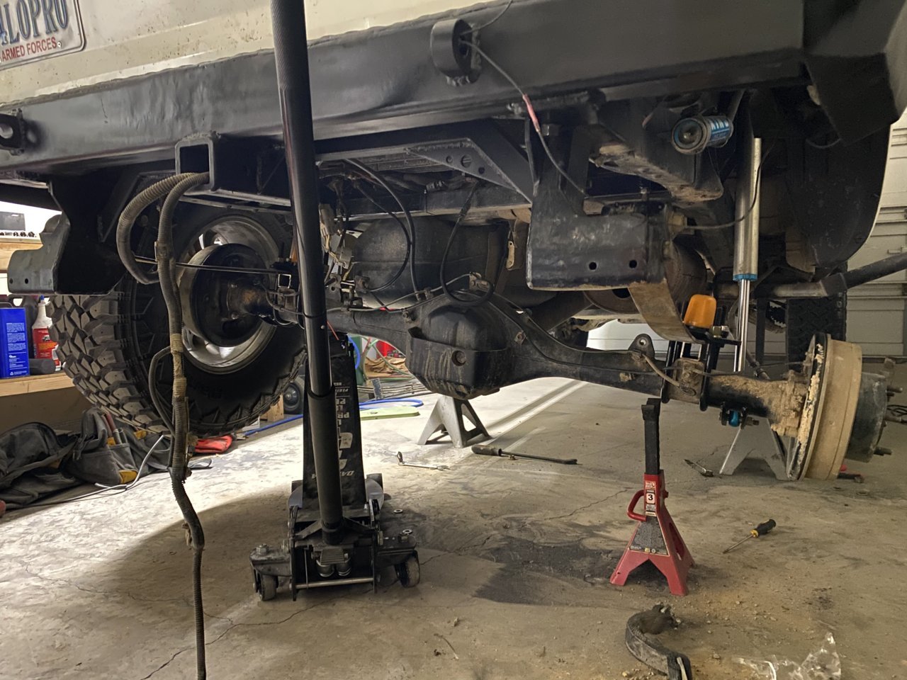

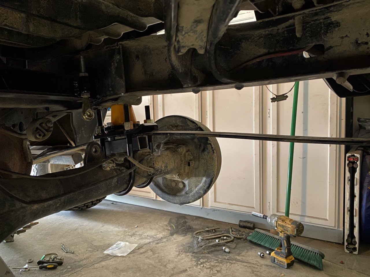

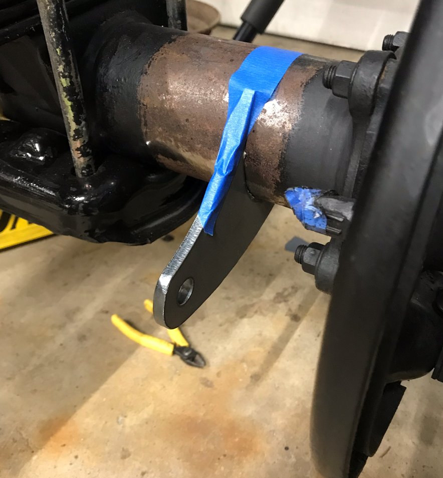

    OK, thanks, we were trying to keep the lower mount closer to the axle centerline, but no real harm in having it hang down right (provided the tube doesn't hit the axle I guess)? We will check the math again.

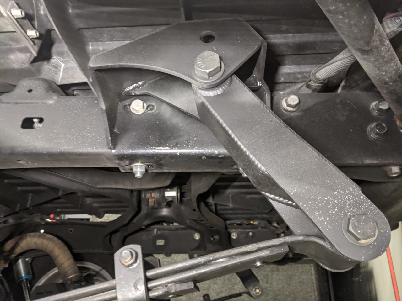

    And how low will the shackles go? with nothing tight, they can get to this position, but once the bushing bolts are tight, will they be able to do this?

    Here’s some pics of what we mean when we say to break down the leaf pack for cycling.
    D86C5D1D-5897-43BD-A1AB-951DBC1FD67B.jpg 09733FA4-60AB-46A6-8034-6E42645758E9.jpg
    it’s fine if it’s lower than centerline. As far as the shackle, you can replace the bushings with polyurethane bushings so it’ll rotate down easier.

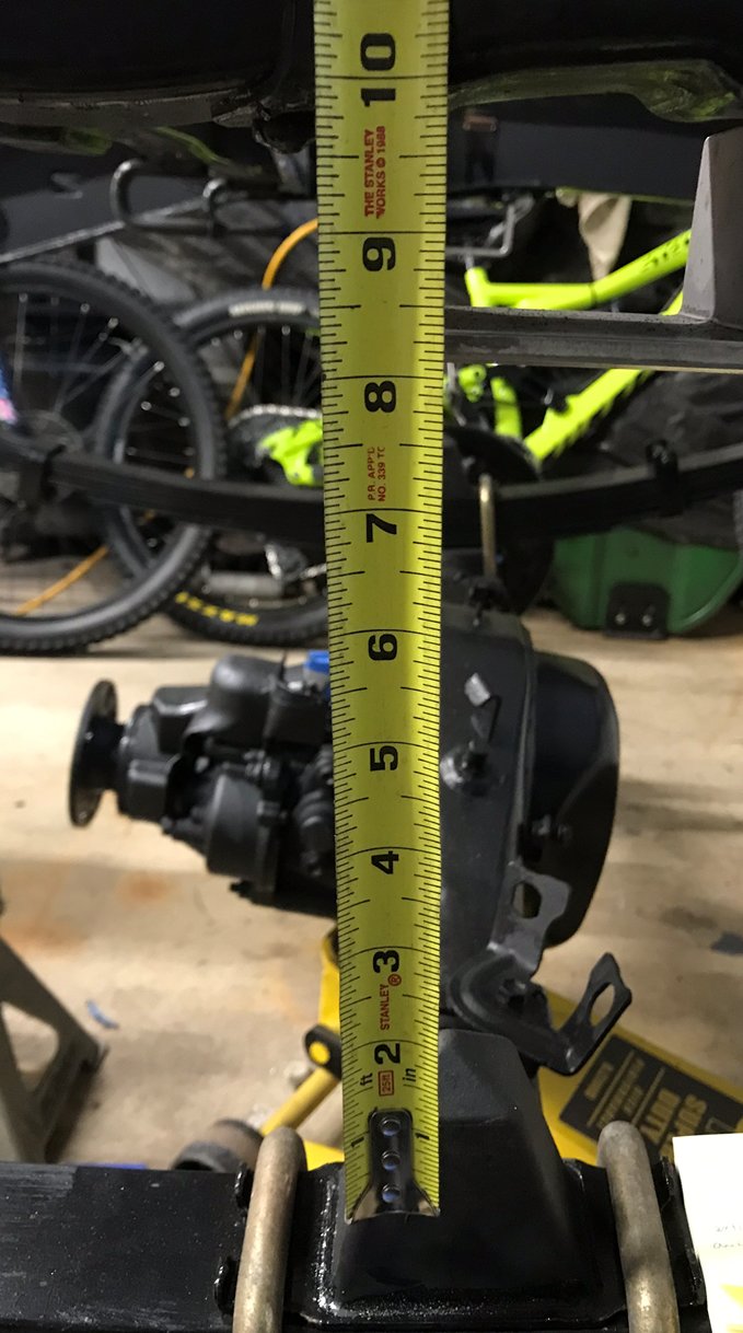

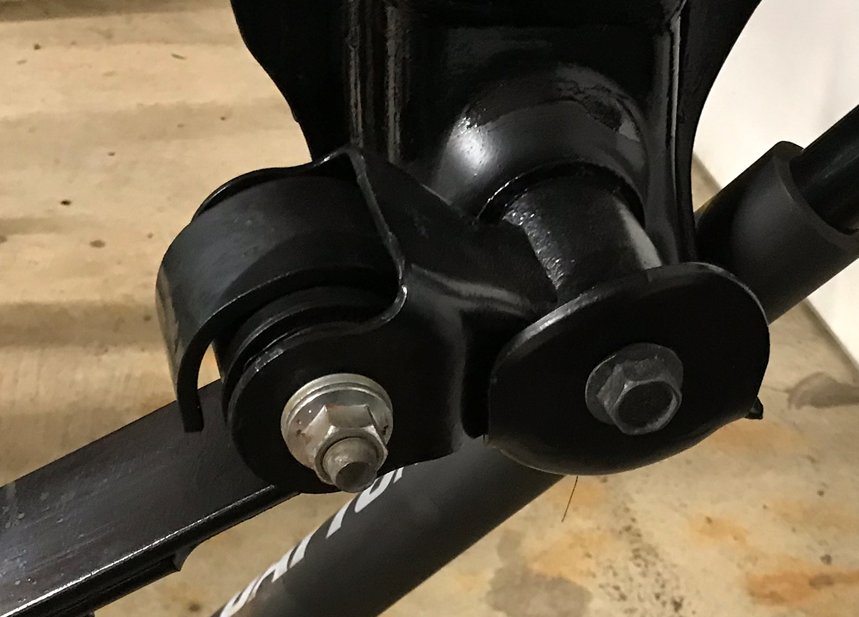

    great advise on breaking the pack down, we may do that, but may need to figure out a way to strap out bare frame down for cycling. but for now here is a picture of where the stop sits when the springs just start to take load:
    and with the lower mounts rotated down to be about flush with the bottom of the u-bolt brackets:
    this would put us at 28.5" shock length with the axle in this position. We are thinking of reducing the bump stop extensions to 1.5" so that when the axle moves straight up 8.5", the shock length would be 20". We are going with the fox performance series shock 985-24-054 which has a compressed length of 18.4". This leaves 1.6" of extra travel for a tilted axle. With the axle let all the way down (with the shackles fully rotated over), the shock would be just under the full extended length of 30.4" leaving no extra travel for a tilted axle so we may add limit straps. Does this make sense?
