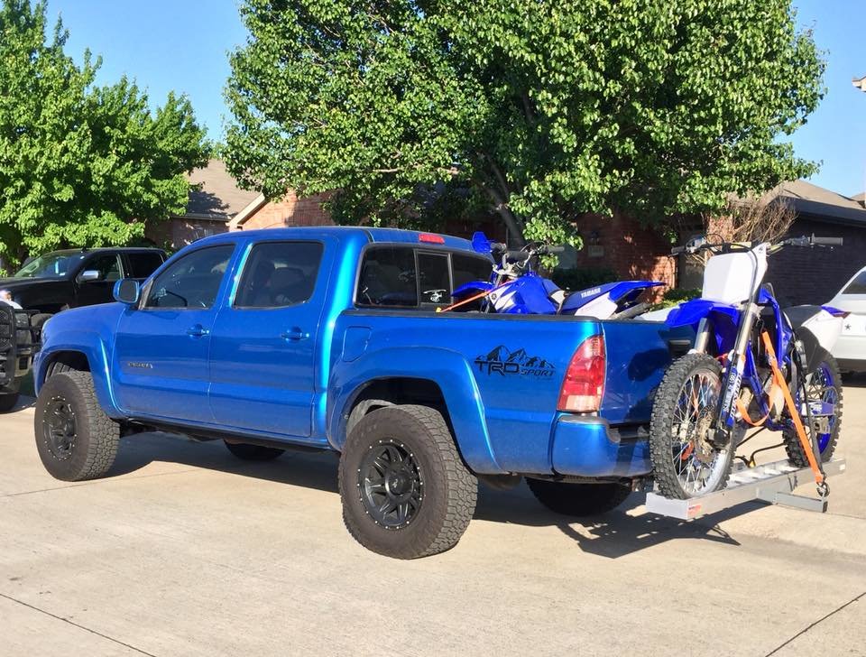

    I have a 36" Pro Comp AAL with the TSB leaves and the truck rides better now! The longer the AAL, the better it is suppose to ride. I left the overload leaf in so I got 2" lift and it supports loads just fine now.
    That's just under a 500lb load:

    I will definitely check into that setup. I believe it would help with the load and also get the rear back above the front. Don't care for the level look as much and with a load like that, it would just sag way too much . Just have to find them now.
