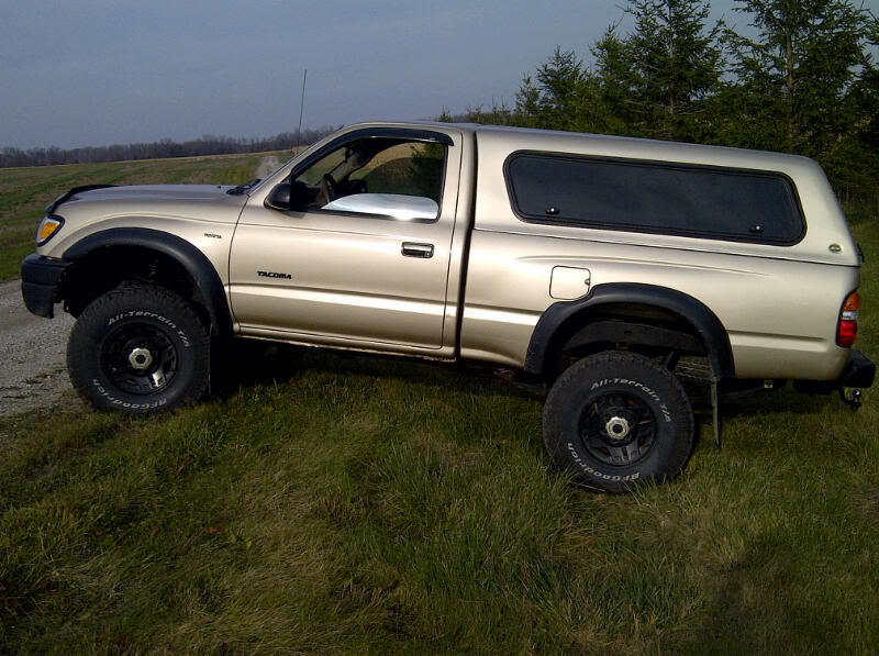

    the dakars on a reg cab will really take it up in the rear.....I put 881s up front and like them...nice stance with some rake unloaded in the rear
