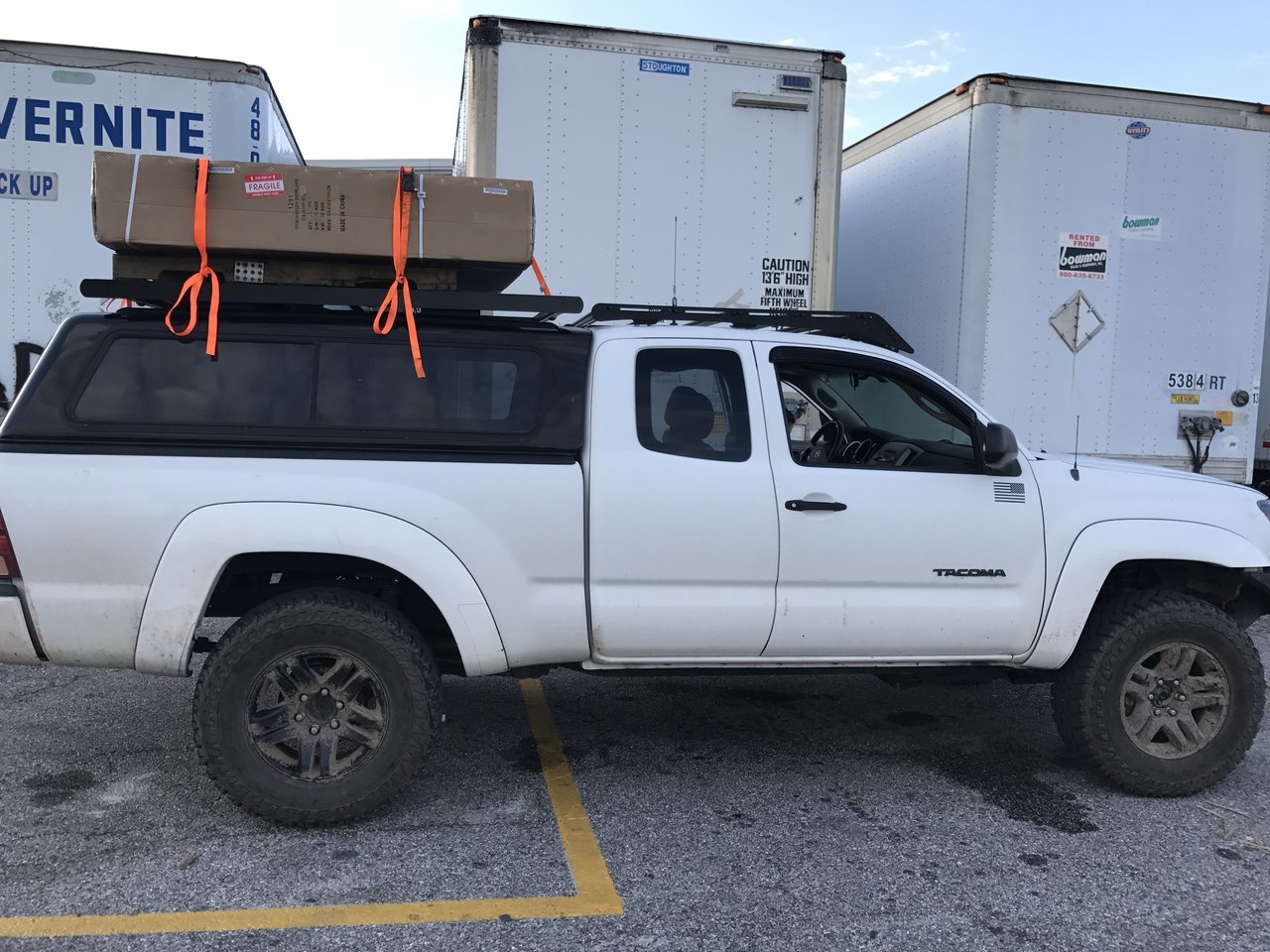

    A single AAL is ~$70 and a fine option. I ran mine for a few months until a great deal on some second hand dakars came alone. I had ~600 lbs in the back constantly, and it barely sagged. I know this isn't sustainable for a really long time, but for an occasional load they'll be just fine.

    Here it is all loaded up. There's also ~300 lbs in the bed from my spare tire, gas can, tools, platform system, etc.
