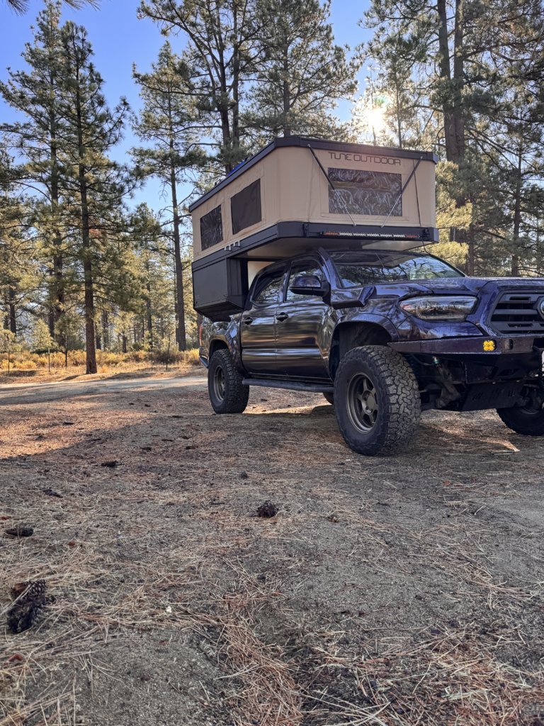

    Any conclusions for this? I have the front frame chopped for increased approach angle, so putting my front sway bar is seems like a bad idea as it would be in front of my skids and catch on things. I got a big camper on the back which really increased the body roll so I am thinking about getting a rear sway bar
