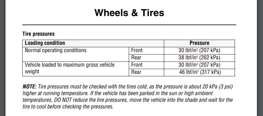

    Hafaday
    Hafaday Well-Known Member
    Dec 14, 2018
    #275828
    5,624
    Bill
    Richmond, VA.
    19, DCSB, Off Road. 23 KLX300, 14JKU
    I find these threads interesting across different forums, as in, Everyone has their opinion and is right.
    I'll add mine as well.. I DO adjust tire pressure just accordingly if needed. That said, the only vehicle I've ever owned that actually put air pressure adjustment in the manual was the Land Rover.
    Reference.... This is from my Land Rover owners manual (not to be confused with the Tacoma). Yes, she did have a fat (heavy) ass on her in stock form.
    Hook78 likes this.
