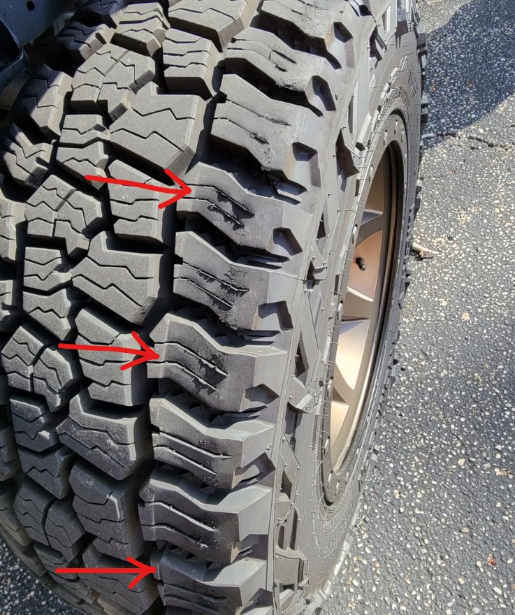

    Time for the OP to end this mystery and come clean. There is a lot, and I mean of lot of bad speculation on this post. I saw the issue immediately. There is no defect in the tires. This is not an alignment issue (you simply cannot align the rear) and it sure as hell isn't an air pressure issue. Shame on you all for once again suggesting the completely stupid chalk test. He got stuck on something and spun the tires. You can see the ridge cut in the tread block on the first pics. He got some traction on that outer edge and it got hot. Very hot. This is why he didn't see it on his previous tires. This is why it is only on the rear.

    A pic to clarify the clear line mentioned in these posts :)

    Genius . You nailed this . :thumbsup:

    Wonder what it could it be rubbing on? There is hardly anything in the rear wheel well especially with a lift. I feel like the OP would have seen this on day 1

    :notsure: Not sure, but I think the point is it seems to not be wear from tire pressure or alignment, but something else alltogether. Whatever it may be.

    If it is rubbing, I am sure he would hear it, but it is possible. Every rub I have had heard sounds like your truck is being ripped apart. He may not have had the rub before because his tires were worn and his new ones have 1/2 more tread. Who knows, maybe he had it over loaded and the tires caught something, but usually your bump stops would hit before your tire hit the bed. This is on the rear so it isn't like it only happens when you turn.
    It looks to me like he spun them on something. I have seen that where people get caught in a storm drain and spin trying to get out. In any case it is clear that this is a self created issue and not something he is going to get replaced for free.
