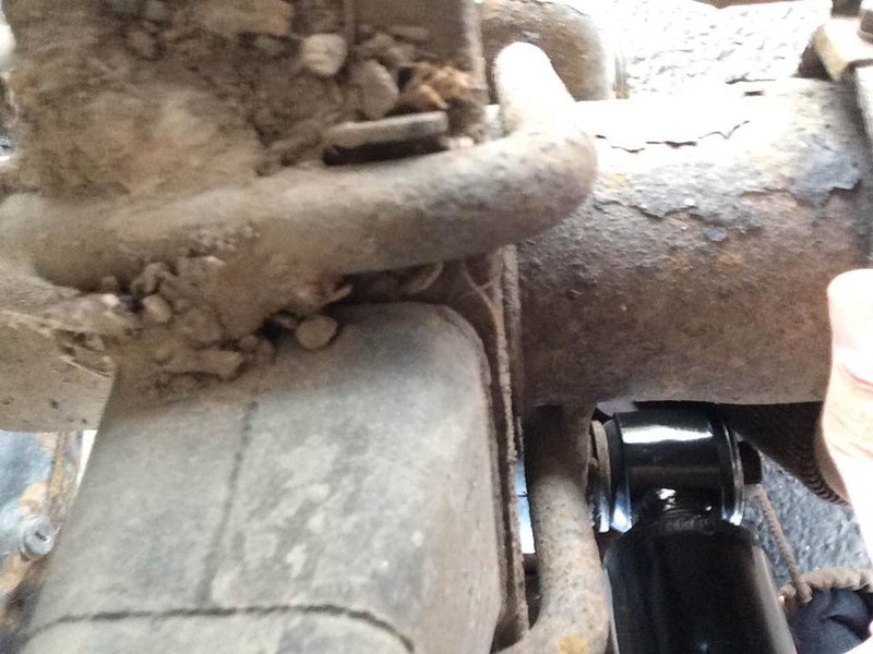

    my 97' was the same way since I bought it, then about 2 weeks ago I added an add a leaf and noticed that the hole on top of the spring perch on the axle on the right side was wallowed out and elongated allowing the axle to slide back. I used a ratchet strap from the axle to the frame to pull the axle forward while I tightened the u bolts and it seems to sit a bit more centered now.

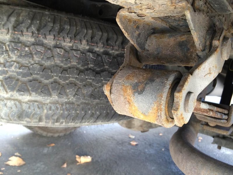

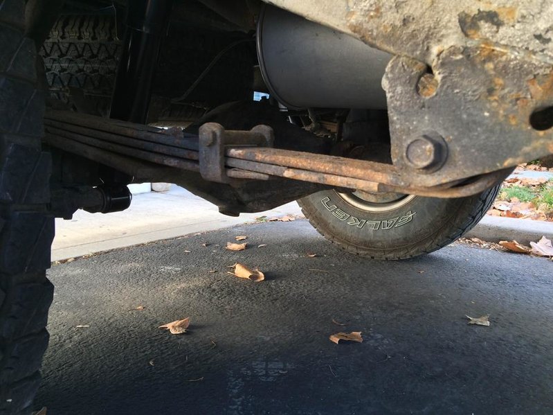

    Thank you for all of the replies. I'm very basic when it comes to these things, so it's giving me something to research and learn.

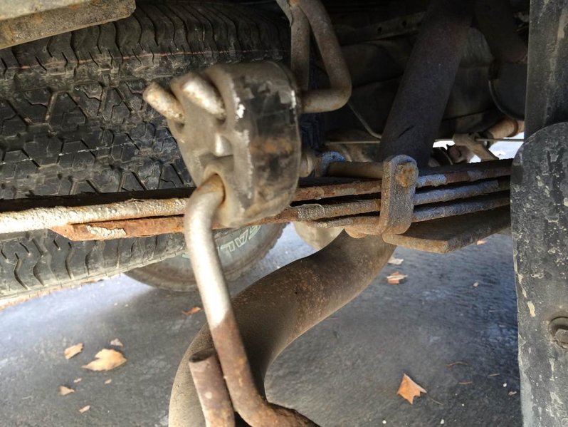

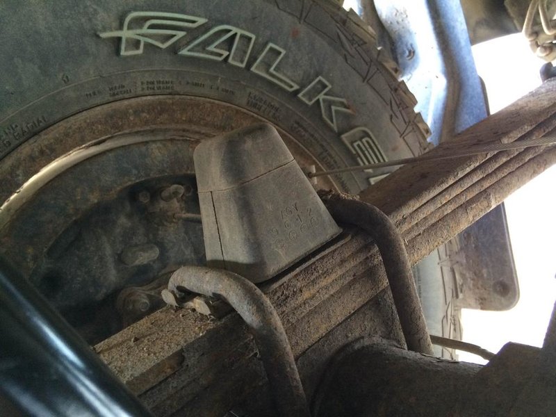

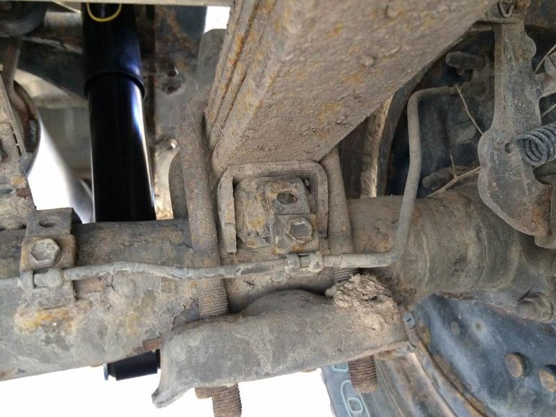

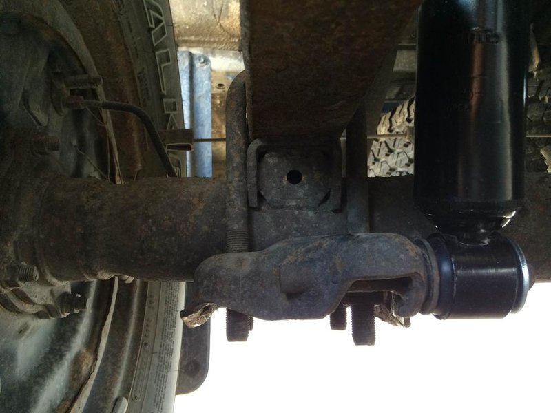

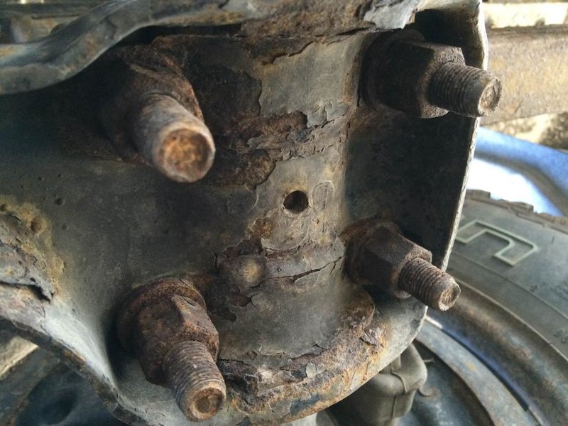

    Here are pictures that I took. I hope it's capturing with what you guys are saying. Let me know if you need more specific pictures or what it could be (if it's enough to say). Not sure how to check if the shackles are frozen..?

    I had this issue on my truck also when I purchased it. After checking all the suspension and taking a ton of measurements the issue ended up being that the bed was slightly skewed in one direction. I loosened up the 6 bolts and moved it, wheels are now perfectly centered.

    After doing some measurements, this must just be an illusion with the mudflap or something.
    When measuring the right wheel, the rear leaf spring bolt site to the rear u-bolt and the front u-bolt to the front leaf spring bolt site measure the same distance as their left side counterpart (give or take around 1/16 of an inch).
    Also when measuring each wheel well to a mark on the tire from rear wheel well to tire mark and front wheel well to tire mark, it too measures the same as it's counter part (give or take around 1/16 of an inch).
    I have no idea at this point.
