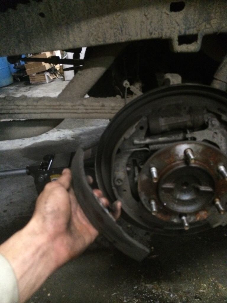

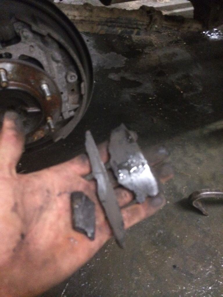

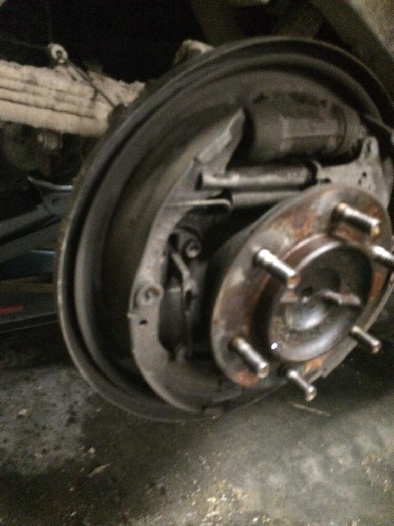

    I had something similar happen to me a few months ago. My rear brakes where locked up and come to find out the pad had separated from shoe and got hung up in the drum. It surprised the hell outta me, I had never seen that before

    Yeah, this. That's why you can get it to loosen when going into reverse, I'll bet.
