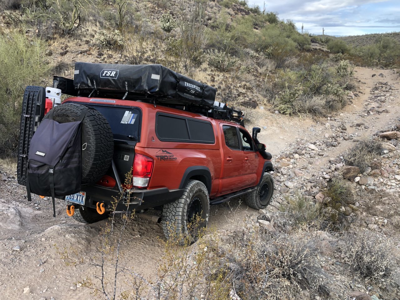

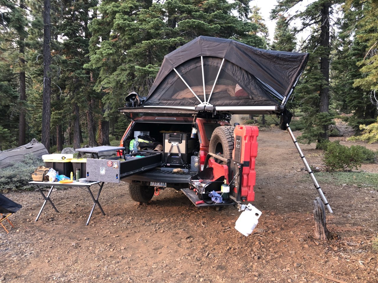

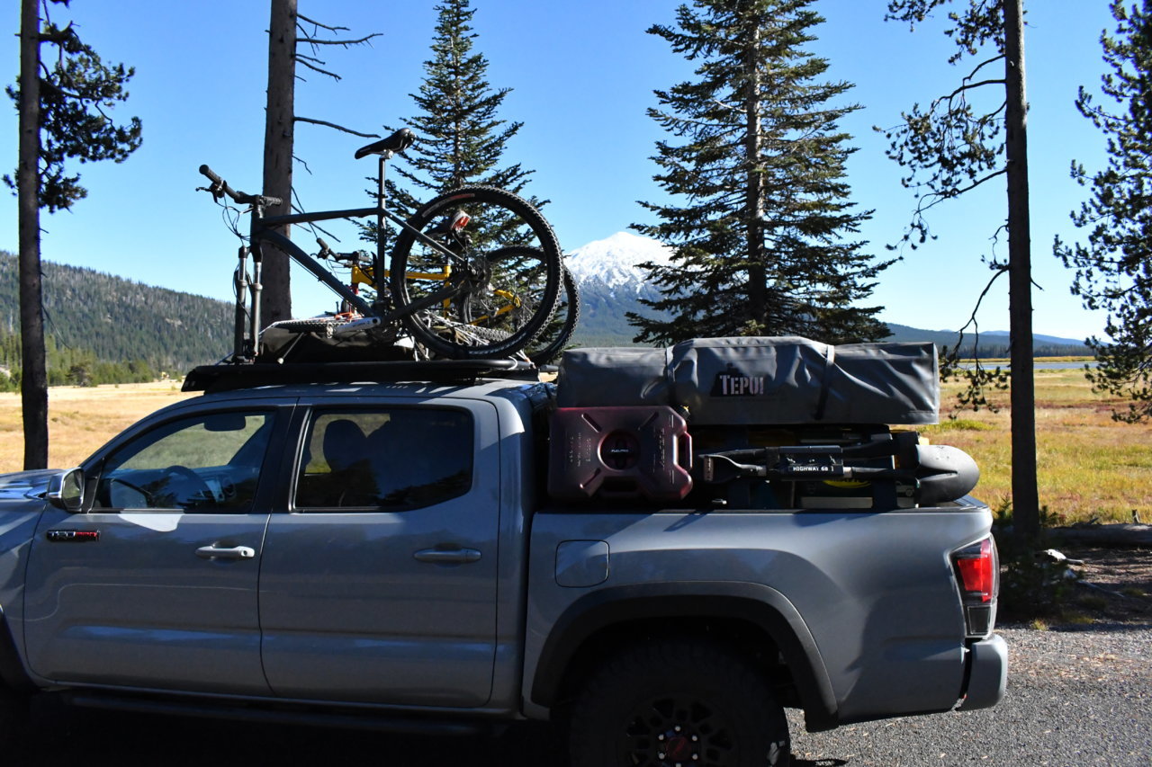

    0F3DBF18-4A7A-4160-A689-3B5E1BB7973C.jpg 3ECAEF07-67C5-4740-8C54-FCA82BFEB7B4.jpg 620CAE67-18FD-40D8-A175-2662E82054A8.jpg B644CDFA-EE14-4195-BC69-975DBC7B3516.jpg 0F3DBF18-4A7A-4160-A689-3B5E1BB7973C.jpg I have been running the Icon stage 9 for about a year now , my truck just keeps getting heavier. Icon suggested that I go with a Firestone airbag set up to help . Or should I bit the bullet and get the Deaver Expedition pack ? What are your guys thoughts

    I might be wrong about this, but I'm thinking both airbags and a new leaf pack. IMO, you should have an overload in your leaf pack. Besides Deaver, Dobinsons might even have a heavier pack than this one. @Crikeymike I also think you'd like Hammer Hangers with that much weight. :notsure: GL!

    Don’t take this the wrong way but have you considered leaving some of the extra junk home that really isn’t needed? Maxtraxx, trasharoo, pelican cases on the roof, Jerry cans etc
    That said it depend on what you are trying to really accomplish. I run stage III Deavers and they are awesome.

    Yes , hammer hangers are in the near future for sure , thanks for the response. I have all the leafs in the RXT , so I think the 1k rated will be the way to go , what I didn’t show was why this is also so heavy . Lol

    Yes , I could leave all that home , but I built / am building this to go Offroad camping /overlanding/ touring ...what ever we call it now a days ... if I was just Off-roading I get what your saying , but I wanted a rv that I could take off road lol ....some day I want to build a tray style tommy camper .. some day

    Put that thing on a diet. I'm reasonably sure you don't need all that stuff. Sure, its nice to have, but sometimes you just need to "ruff it" a little.
