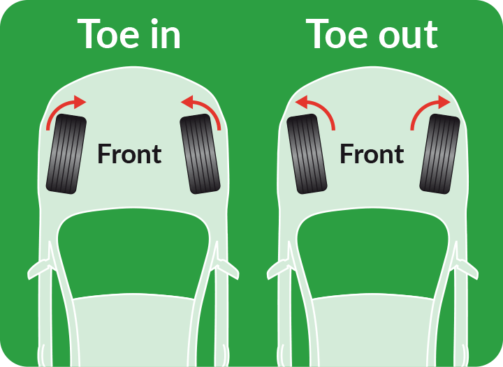

    Am I not reading that right?
    Toe?
    That would be the amount the leading edge of your tire is pointing in.
    For that to be an issue on a solid REAR axle, you would have to have a bent axle.
    What am I not getting?

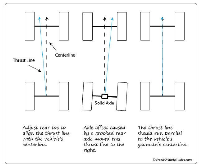

    Or is the rear axle throwing off your thrust line from the center line because one wheel is slightly ahead of the other wheel?
