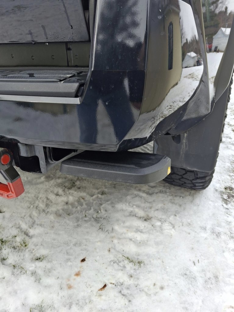

    Yes. They use the same mounting point. There's one company I saw working on an offset bracket and altered step mount to get both in place.
    If I never have to use the recovery points on the truck, I'll be happy, but I'm not doing regular ORV activities.

    You can't run the ARB (or other?) tow hooks on the passenger side with the step as there isn't enough clearance for the step. You need an offset bracket from SXTH to move the step away from the passenger side tow hook and further toward the passenger side edge of the truck.
