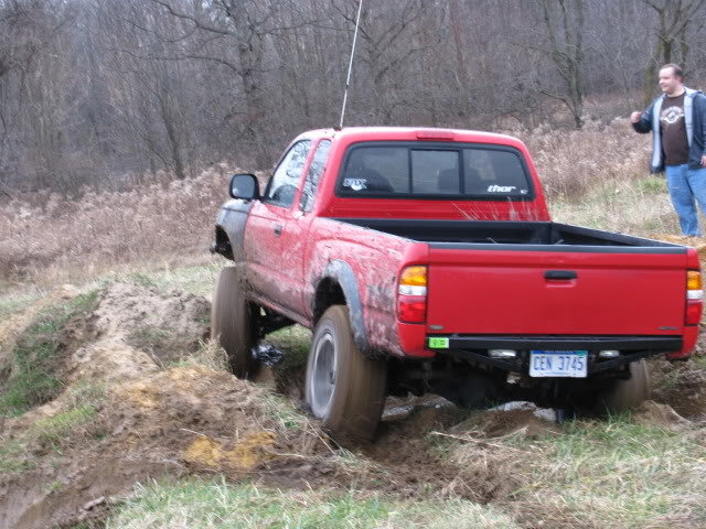

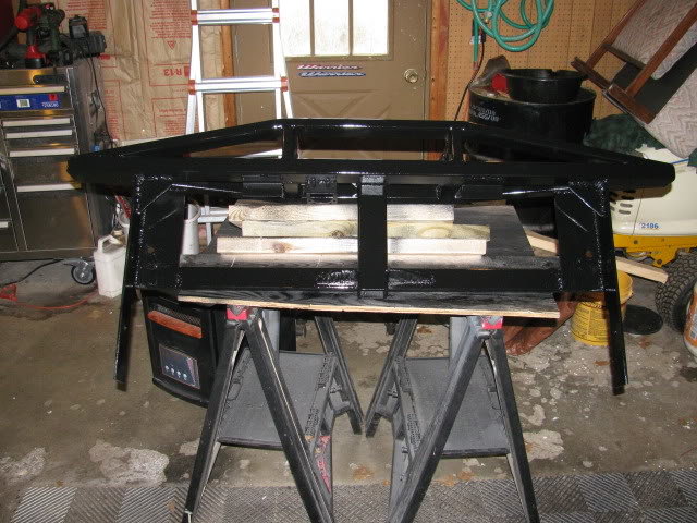

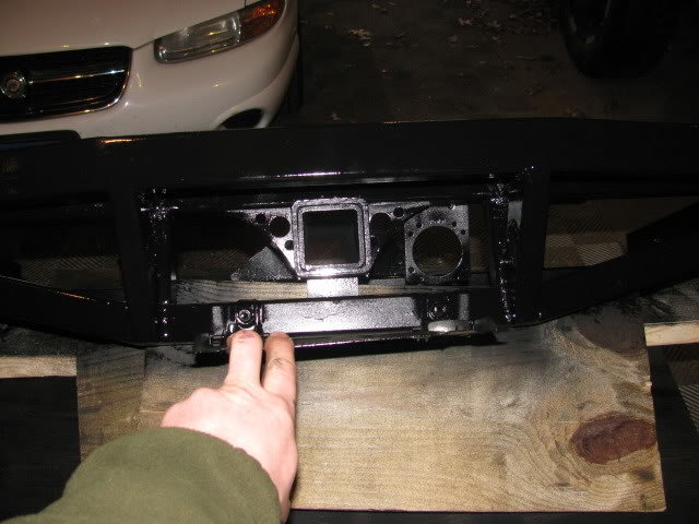

    heres how I did my hitch. Just put it behind the license plate with a flip down plate holder.

    I dont have any great pics but here you go.

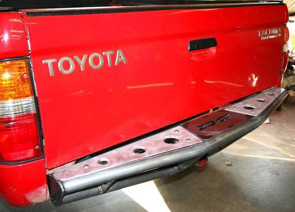

    Shrockworks makes this one and it's not quite pre-runner but it's tight, compact, and different.
