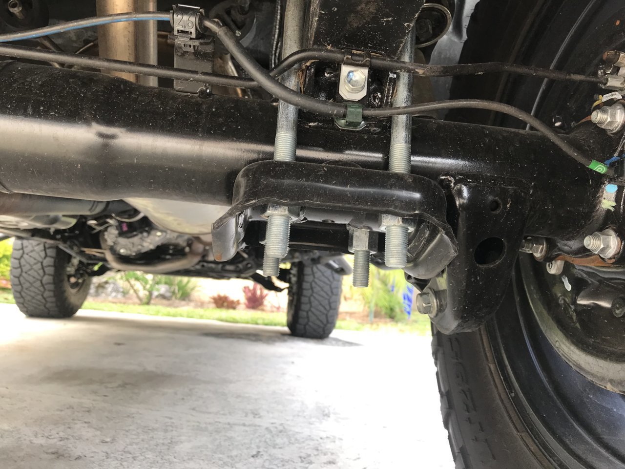

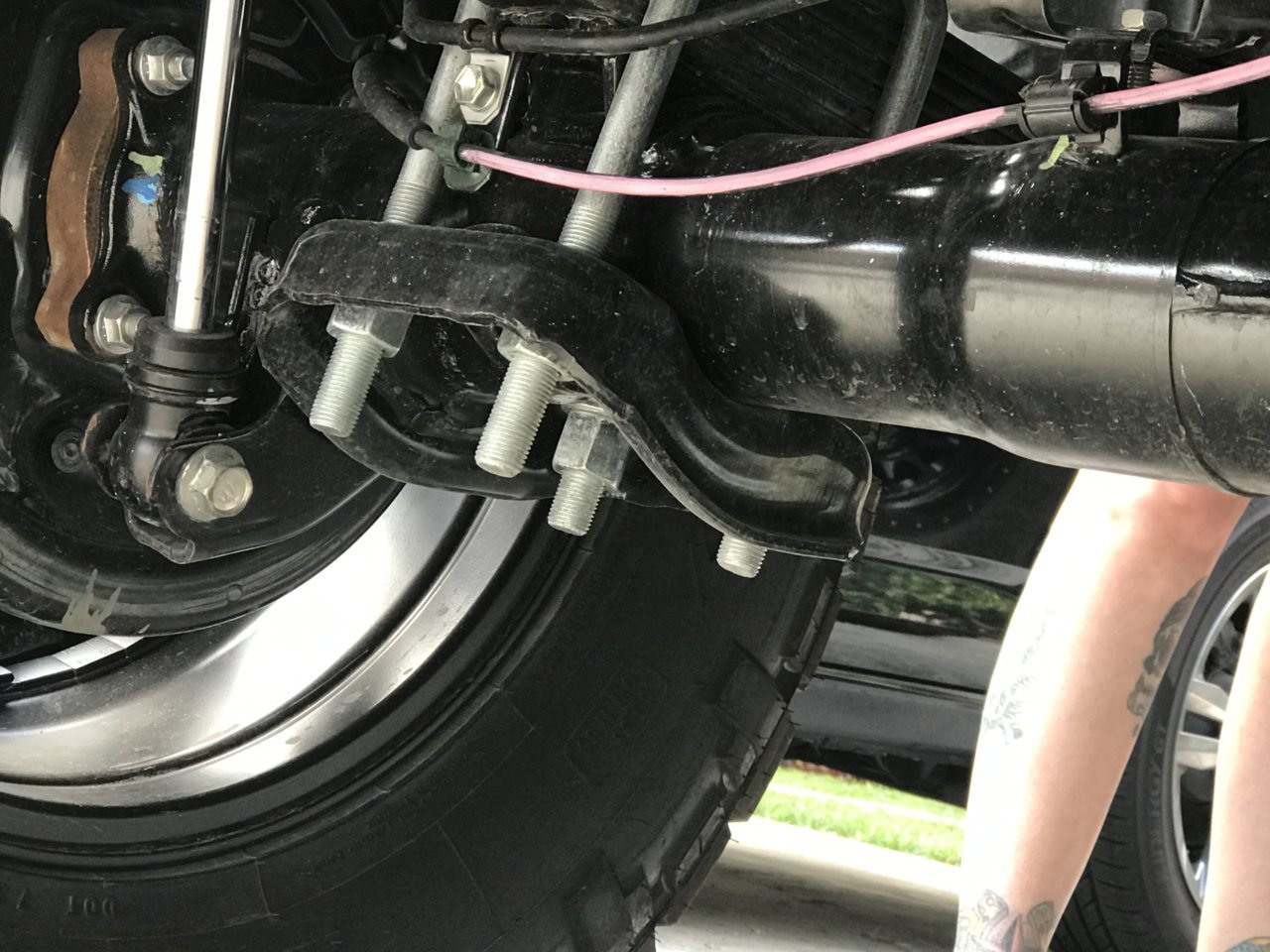

    guys i had a leaf pack installed a few months ago.. i just noticed that the u bolts are uneven on both sides.. some have more threads showing than others.. just wanted to see what yours may look like or if this is normal.. i put a wrench to them and they are all tight.. C7E8508F-B34E-4B75-974C-1092AB5AA1E7.jpg 7C667C2A-30B3-4AA7-AD67-257CC5B51D63.jpg
    You can see that the driver side is angled differently than the passenger.. i don’t know if this has anything to do with the shock location being different on either side.. anyway i had a horrible install done on all accounts and it wouldn’t surprise me if they F’ed this up too.. anyway lemme know
    Thanks..

    You're fine if they torqued down to spec, you'd have to do them in increments exactly the same at the same time to get em perfect so no worries haha

    Ok even with the base off kilter like that? on the drivers side..the only reason for my scrutiny is that this shop messed everything up..& i mean everything..so I’m thoroughly looking at everything..

    It would probably bother me, it's not ideal, but if it is torqued all the way down to specs it shouldn't be unsafe either. Maybe see about having them correct it though, if they do correct it new u-bolts are required as they aren't a reusable part. You could actually easily do it in your driveway if you own a jack and a torque wrench

    It shows maybe a lack of attention to detail but as long as they are torqued to spec it's not a problem.
