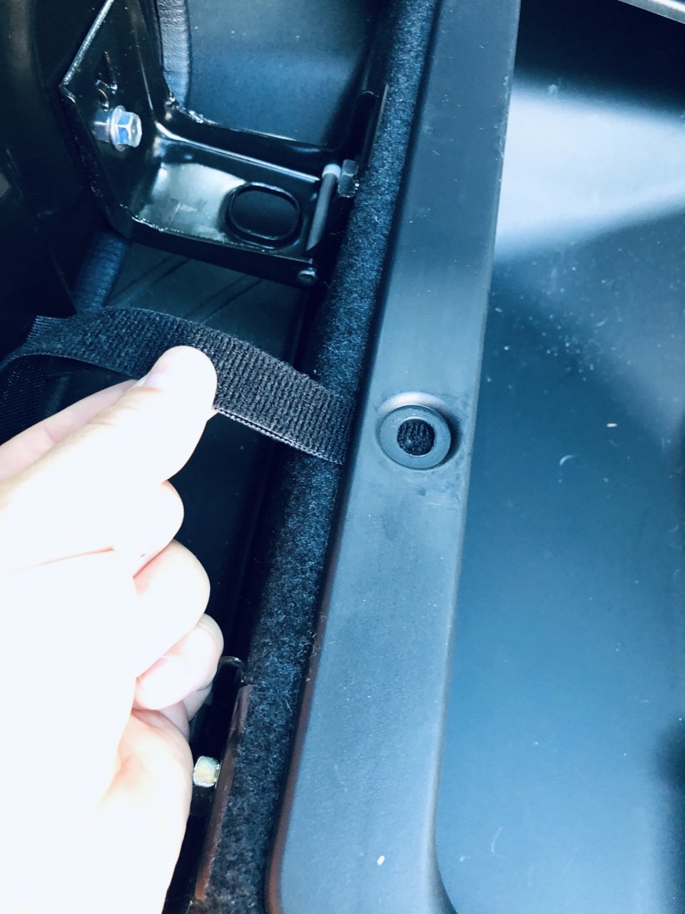

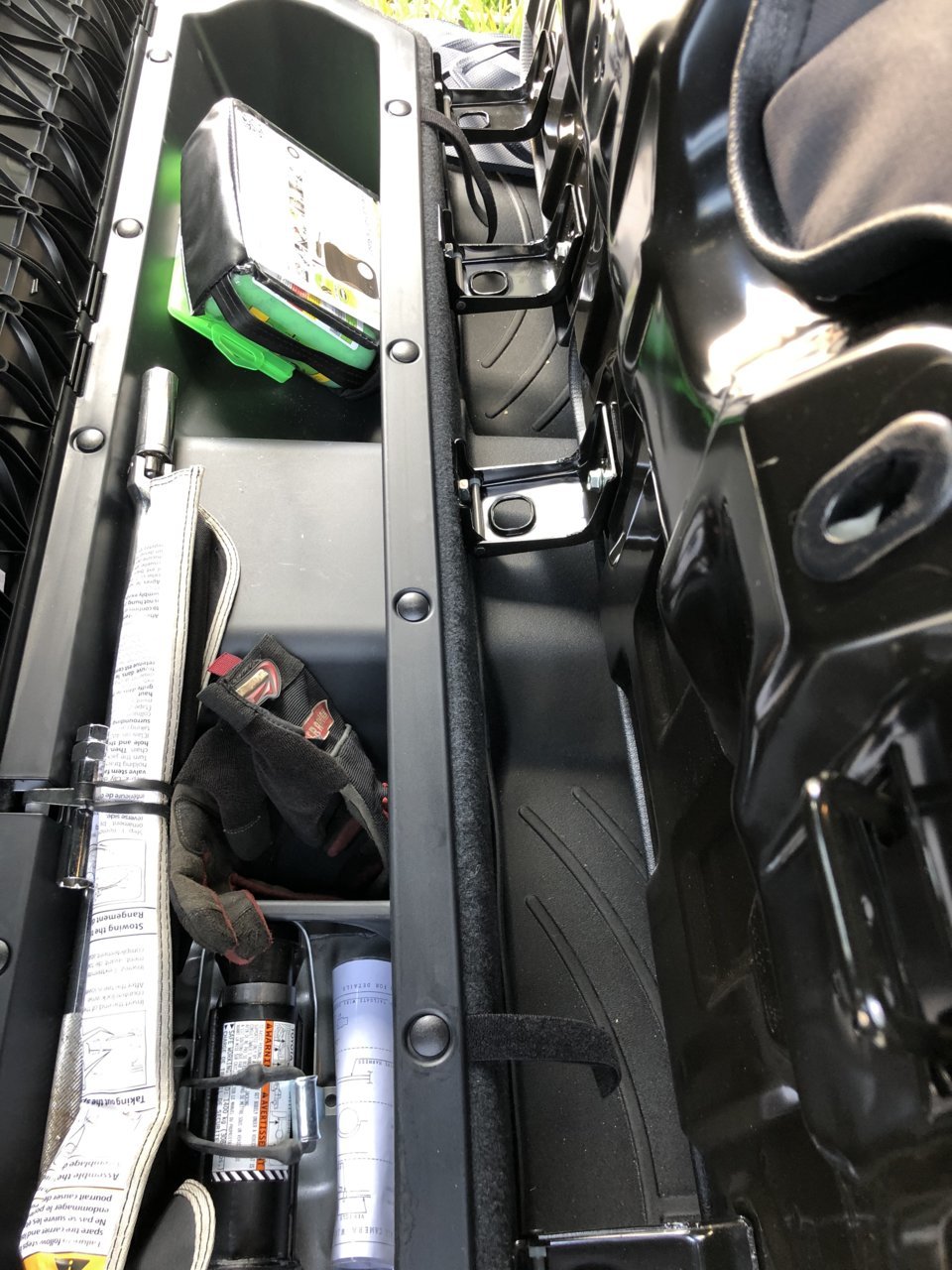

    I have a nice golf umbrella I keep on the floor in the back of my truck. It constantly rolls and bangs around. I thought of a nice solution to remedy this. Maybe it can help people with the same issue?

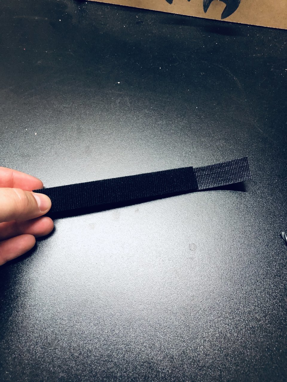

    - I went to a local Michaels (had a coupon) and picked up the One Wrap Velcro. It was about $7 for the roll. This had a tarp wrapped up so I thought it would be a bit more “heavy duty”. This product had a soft side and the plastic side.

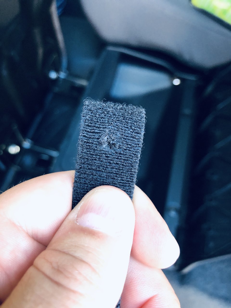

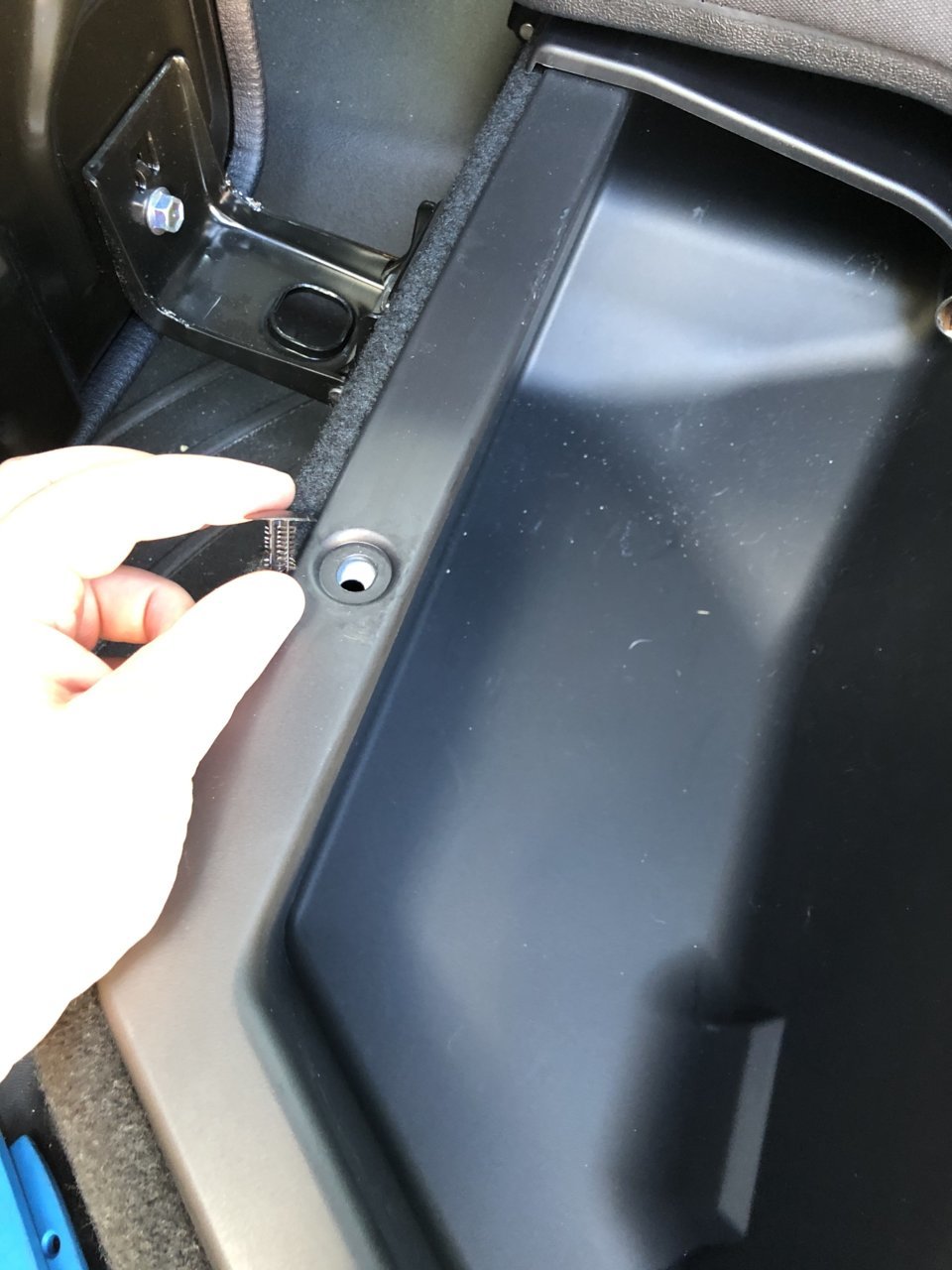

    - I first started by pulling forward the bottom rear seats, opened the top for the storage area and removed the Push Fastener. I cut a 14” piece of the Velcro. I folded it (soft side out) with about 1 ½”- 1 ¾” overhang. I drilled a hole using a 3/16 drill bit.
    - I installed the folded part of the Velcro between the body of the truck and the plastic rear storage. Longer part on top and again soft side out. I Reinstalled the Push Fastener through the hole of the Velcro. I repeated the steps on the passenger side. I close the storage and put the seats back down to its normal state.
    - Now all you need to do is strap up your umbrella using the Velcro straps. Sits in there nicely. Make it as tight as you want or leave it a bit loose so you can slide it in and out without any problem. Please note, it may be in the way when you try and pushing the bottom of the seats forward. So, adjust accordingly.
    I have a crew cab but sure it can work for the access cab as well. If you have a smaller umbrella I’m sure you can just use the other holes to fit your umbrella. Let me know how you like this. Thanks for viewing.

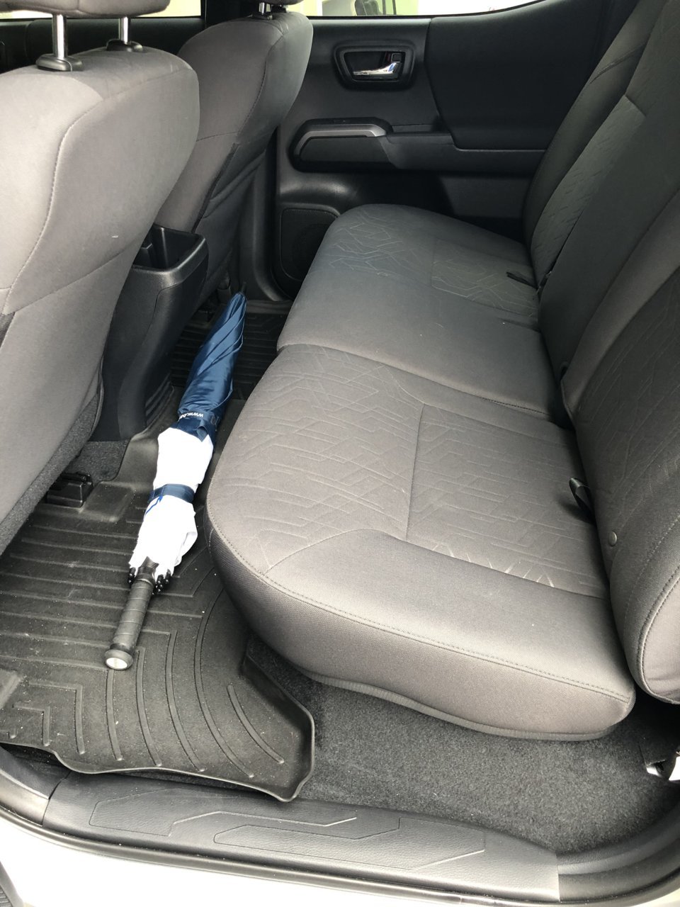

    I just put mine between the seat and the area that’s always pain to vacuum. Never moves but the Velcro is a good idea
