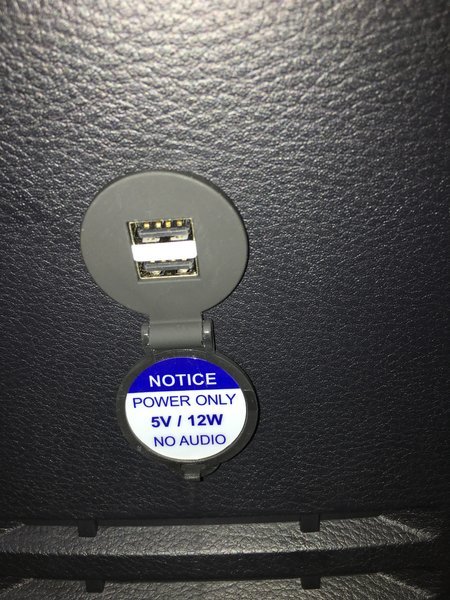

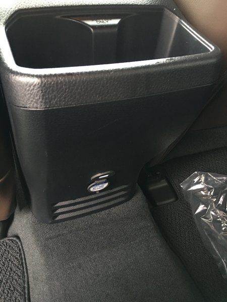

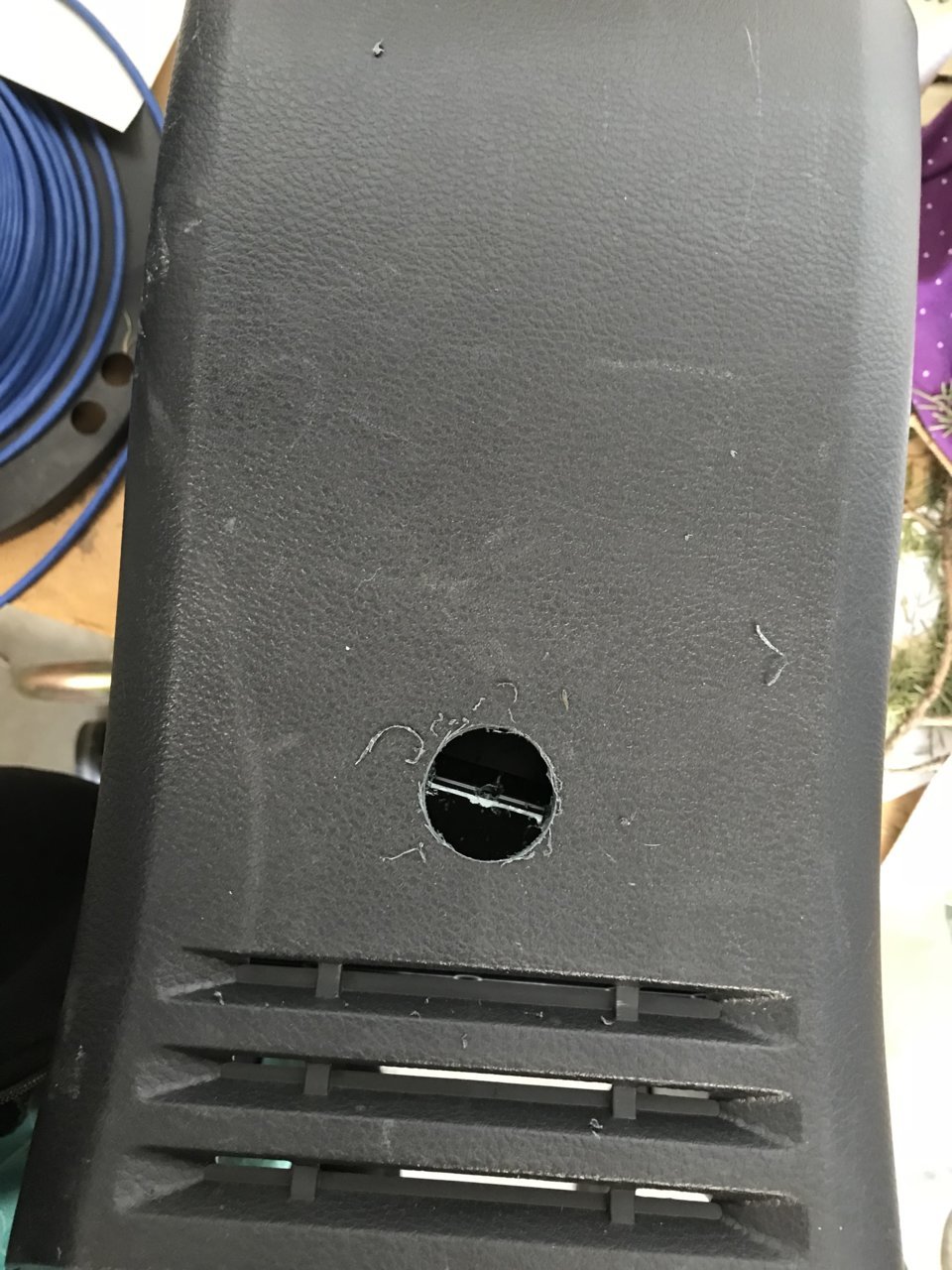

    I installed this:
    https://www.amazon.com/BlueFire-Charger-Socket-Outlet-Voltmeter/dp/B01F3I117E/
    After removing the console I bored a hole for the charger socket, then ran a line up to the front of the cab and to the passenger kick plate. I then wired in a 5A inline fuse there and spliced it to my dashcam power line which goes all the way to a relay / dedicated fuse panel in the engine compartment. I didn't take any pictures while everything was torn up, but can answer questions.

    I already installed it. What would you like to know? I can take a picture of the finished product from the back seat if you want me to.
    The important thing to know is that the entire center console can be removed if you take the carpet out of the armrest cubby and remove the bolt(s) underneath and then work the clips out from around the cupholders back.

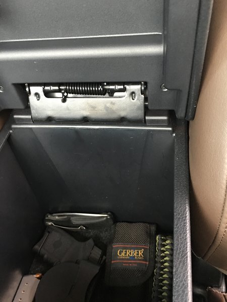

    Just a quick lesson learned to anyone who plans to do this mod: Take the extra 5 minutes to remove the armrest area entirely. There’s a cross member that will mess you up if you’re not careful...
