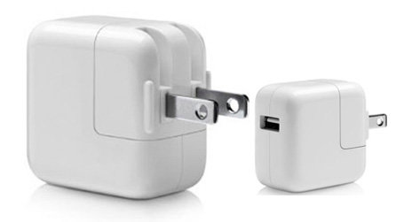

    Yeah I wired it to the inverter with the 400w anytime mod.
    If fast charging is needed you can always use this. Also, I like the outlet since it’ll charge a 120w laptop, or two.

    Builtin is so much better. How long would that last sticking out with kids in the back seat? Not long, I'm betting.

    Probably not, but I don’t have kids. But I do have a lot of rechargeable devices like flashlights and some with a standard AC plug, so that’s why I went the route.
    There’s a ton of USB outlets online to choose from and yes just wire directly to the inverter.
