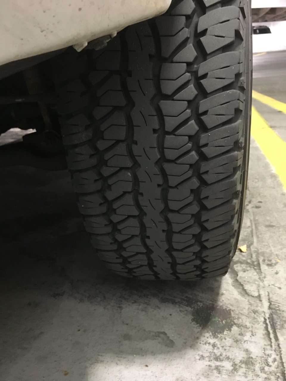

    Last Friday I drove my truck to work and ran 4WD for a bit like I try to every month. Drove to work no issues. Drove home, no issues that I remember.
    Parked the truck Friday night, didn’t touch until Sunday morning.
    Father in law and I get in the truck Sunday and drive down the road. Between 10-45mph we both look at eachother like “uhhh truck is shaking bad, something isn’t right”.
    Truck visibly shakes in the rear starting at 10mph. You look in the rearview mirror and see the bed vibrating.
    Vibrations kind of mellow out past 45mph then turn into a tonal hum but there is no bad sound. Its like how knobby tires hum differently but theres no noise coming from the truck, just a hum.
    Its not the engine, not the trans, not the diff, and there are NO driveline vibrations. All vibrations are felt in the body of the truck, I cannot feel any vibes in the wheel.
    Vibes to me feel like drivers side rear wheel/hub.
    We checked under the truck. U joints are fine, drive shaft still has its two weights, leaf springs are flattish but not frowning or cracked, struts look fine.
    Yesterday I took the truck into the shop where I bought my tires and asked they check the balance on the rear wheels. Sure enough 4oz off on the drivers side rear wheel. They fixed, test drove and still said vibes were there.
    They did an alignment, test drove, still vibes.
    Tech said tires are starting to show cupping and thats the only reason he can see that will cause the shaking. He has checked everything else.
    Told him to show me the cupping, I’ve never noticed bad wear on these tires ever, and I pay attention.
    tech and I checked out the truck. I see no cupping. We messed with the hubs, wheel bearings are fine. No catching, no griding.
    I said OK. They quoted me a new set of tires and will honor the quote all year. Told him I’m not looking to replace tires that look fine now but if they get worse I’ll know its the tires then replace.
    The trucks shaking is resolved by about 50-60%, but there are still rear vibrations.
    Again no noises coming from the truck, just a vibe that starts at 10mph then turns to a hum at 45+mph. This occurs with acceleration and with the foot off the gas and braking.
    No vibes in the driveline.
    Am I missing something?
    Do I need to have someone else check it?
    See pictures of my tires below. I forgot my alignment spec sheet but will post if needed.
    I see no cupping.
    Plus I rotate my tires religiously, the cupping should be uniform even if it was there... I feel nothing up front, only the rear.
    I honestly feel this came on suddenly not slowly over time. Truck was parked in the garage at home between the time it was fine and the time it was noticed.
    Any advice or opinions are appreciated. I just want to make sure I don’t ignore something important.
    The only thing I can see is less wear on the very outer edge of the tread. I could probably air the tires down a bit.
