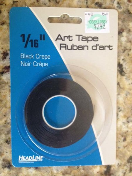

    1 - Get some super thin tape. I found this at a hobby store.

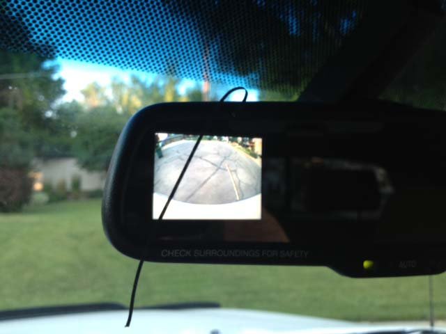

    2. Get some PVC pipe, 2x4's, long straight poles, to mark the edges of your truck. I had two 10' lengths of PVC pipe in the garage so I used those. Place them next to your rear tires and make sure they stay parallel to each other. The idea is to mark the edges where your truck ends. They don't need to be as long as the truck, just long enough to provide a straight line to mark.
    In the picture, on the right side, you can see a white line, that's the PVC. I just took a length of tape stretched it tight between my hands and stuck it down over the white line.

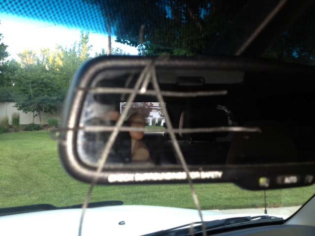

    3. Here is the work in progress. I took a razor and trimmed the extra off.

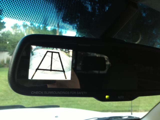

    4. Here's the finished product.

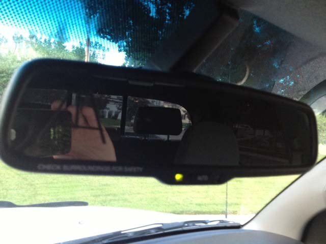

    - and what it looks like during normal driving
    The top and bottom horizontal lines mark the full length of the truck and 1 foot beyond the rear bumper. The center vertical line is the center of the truck and the two outside lines mark the edges. I don't find the tape on the mirror a bother in the least. I never use that part of the mirror in normal driving.
    I've had this on the mirror for about a month now and really like it. A quick glance tells me if I have to worry about hitting something or not. It has proved its worth many times during parking. A surprise bonus was the improvement for parallel parking. It was easy to tell where the curb was in relation to the edge of the truck and just how close I could get to that guy's bumper without hitting it.
    For $2.50 I'm pretty happy with the result. Sure beats the $1,000 price of a replacement mirror.
