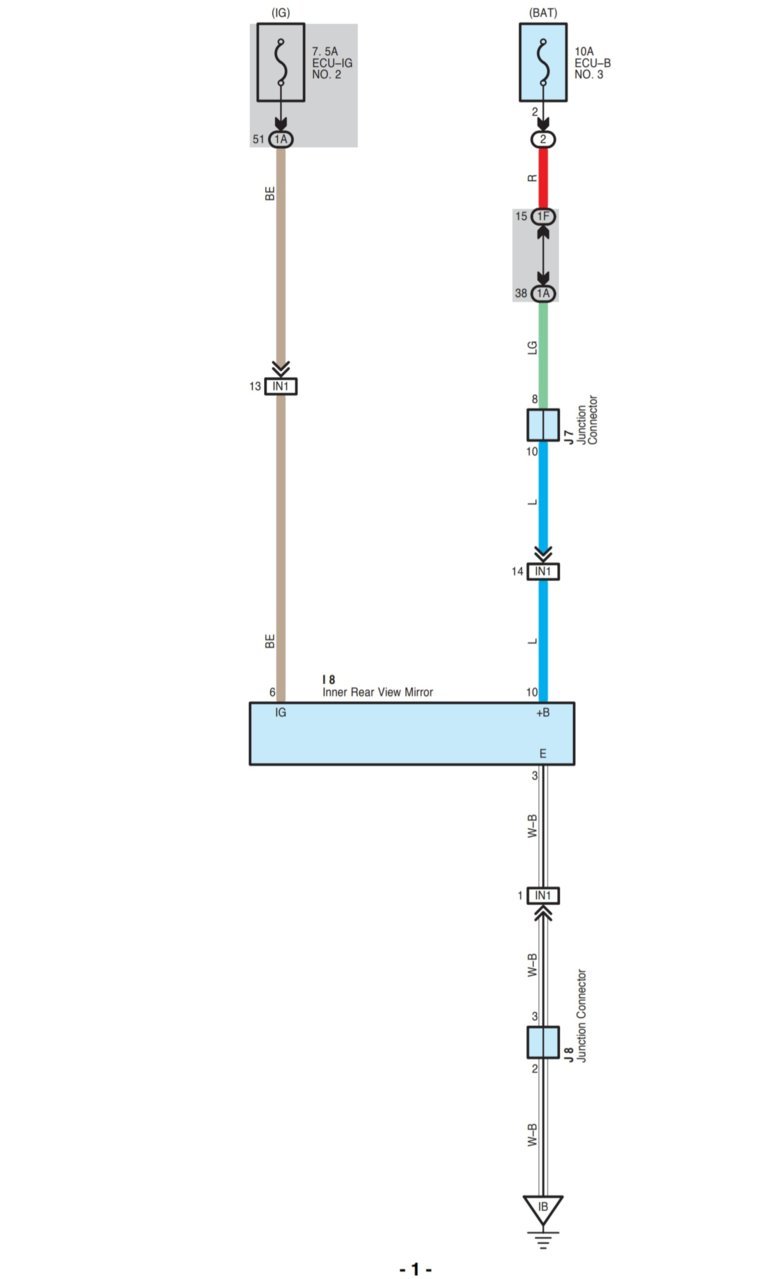

    The new rear view has a power cable that connects to a plug for a cigarette lighter I am assuming 12 volt ????? am I correct that would be like the standard power ?
    I would like to know if the plug I disconnected from the stock mirror is also 12 volt so I can just use that to power the mirror dash cam

    Yes it is 12 volts. Here is a diagram for 2016. Not sure if it is the same for 2022. It's a starting point though.
    Verification with a multimeter will confirm if it is the same.

    awesome thanks
