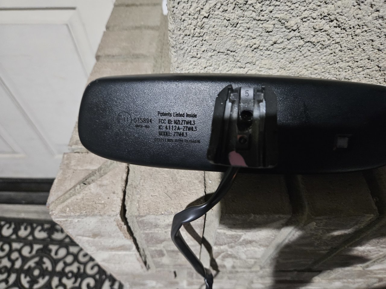

    Not Tacoma related, but my wife wanted a Homelink Mirror for her Toyota C-HR and I was able to score a second hand mirror, now I have to wire it up. Wanted to know if anyone here could identify or has access to wiring diagrams to help me out (giving that her current mirror is integrated into the forward crash avoidance, i dont want to go probing around if i dont have to).
    Anyone know what type of connector that grey connector is - and have access to a wiring diagram, i would like to be able to pull out 12V, IGN, and GRND to go into the HomeLink mirror. Current mirror looks like it is taking IGN and GRND (judging by the 2wires going into it and it not operating when the vehicle is off).

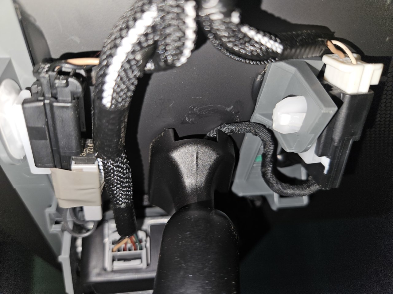

    My guess is the beige wire is GRND and the White wire is IGN. As those are the only two going over to her existing mirror:

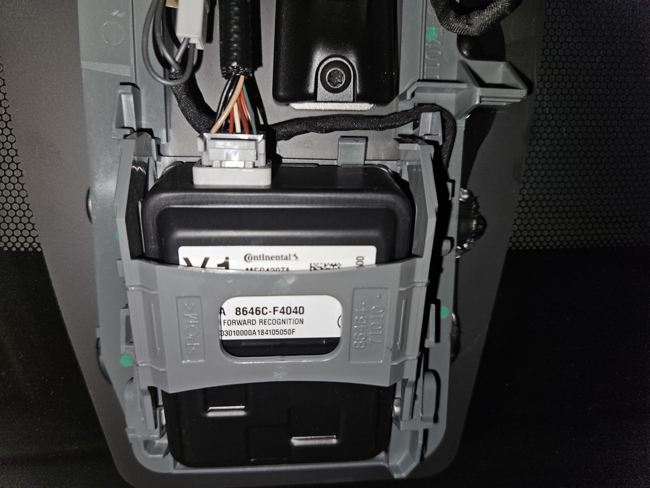

    The goal is to create a pig tail jumper for that grey connector and splice in the new mirror cable.
