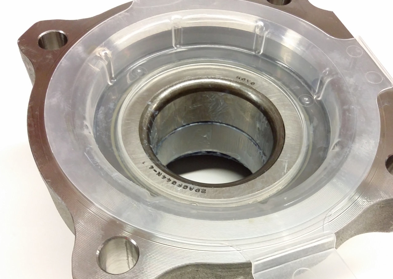

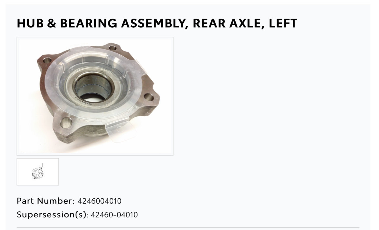

    While I’m not 100% certain, I’m pretty confident these parts should work. (In the links below)
    Toyota and the link below both match.
    Bottom of 1st post here - https://www.tacomaworld.com/threads/2nd-gen-rear-axle-bearing-diy.246760/
    I’ll tag @maxamillion2345 to get his input here.
    Toyota list this at the part.
    The picture here and in the link above to the DIY both match.

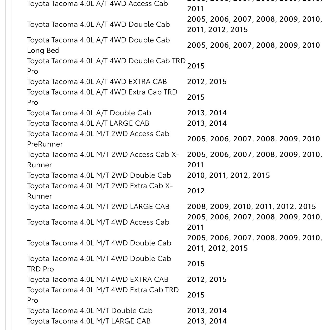

    As well, according to Toyota, the parts are the same for all 4WD Trucks.
    (This is why I feel confident that the parts are the same)
    Part# on the bearing looks to be 2DACF044N-4

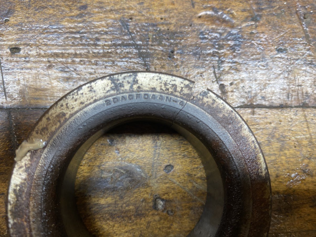

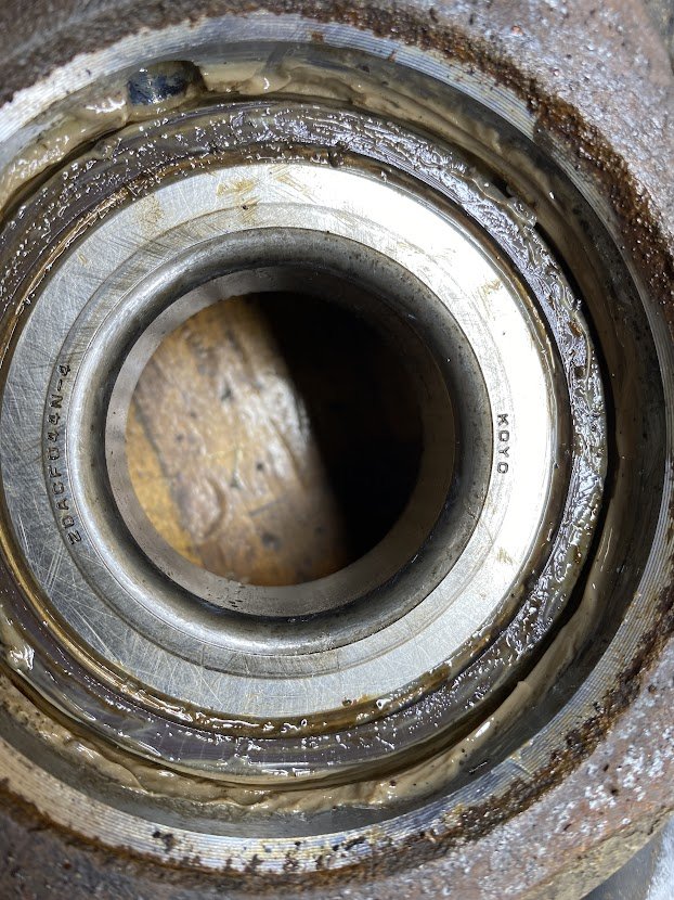

    Not sure what parts you'd like but they are a unit bearing so I don't think you can purchase the bearings separate from the housing or even if you can it would be a bear to get everything lined up. What I did was get each side through Rock Auto. I got Timken assemblies which use Koyo bearings. Below are the PNs of the bearing assemblies I used. If you want the stamp number on the OE race of the bearing, I just went out and took a picture, it's a long number (2dacf044n-4) which are also Koyo bearings. Searching that number yields the whole bearing assembly. Let me know if you need any more PNs I was planning on doing a writeup with all the parts I used.

    The "seal ring" I wrote about can be seen better in this picture. If you look at the left side of it you can make out some kind of Koyo part number. It appears to be a harder metal sleeve pressed onto the axle. I could definitely see a difference in the surface finish quality, as well as a distinct circle showing where the axle and the sleeve came together. At this point I'm guessing if someone were to order a new axle it would come with this sleeve already installed. The crappy drawing shown on the Toyota web site doesn't show that part of the axle.
