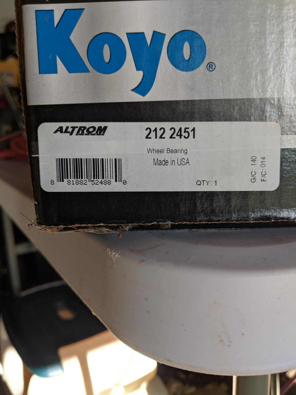

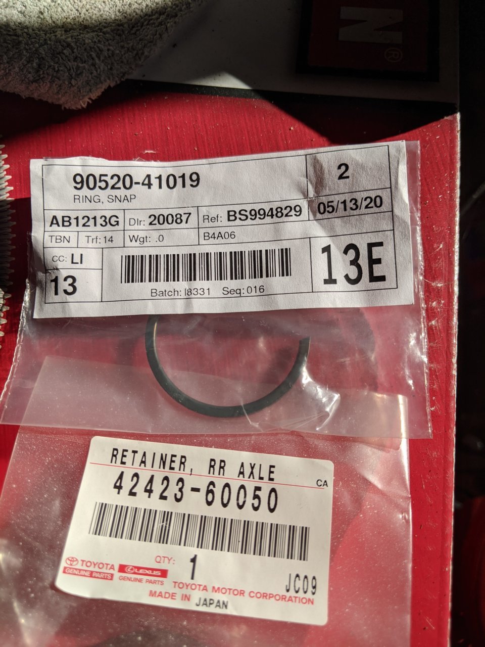

    I'll take a pic of the parts needed for this not so fun project, as I have yet to do the other side.
    Napa sells the Koyo bearing and hub assembly for a reasonable price. Parts from the dealer were the lock ring, spacer, washer along with O ring and seal. 2 each for both axles.
    Do yourself this favor if at all possible BEFORE dropping the axle off. Remove the locking ring and spacer. It'll save you my headache of having a bent axle and or damaged splines.

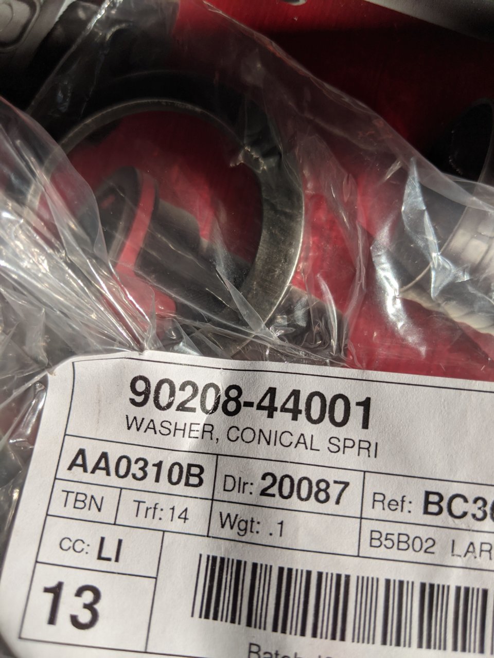

    Alrighty.. pics and part numbers for all but the Oring. Wtf did I put it. Lol
    The o ring goes on the axle tube before you reinstall the axle.
    The other parts are self explanatory. Pay attention to the washer. It installs correctly one way.
