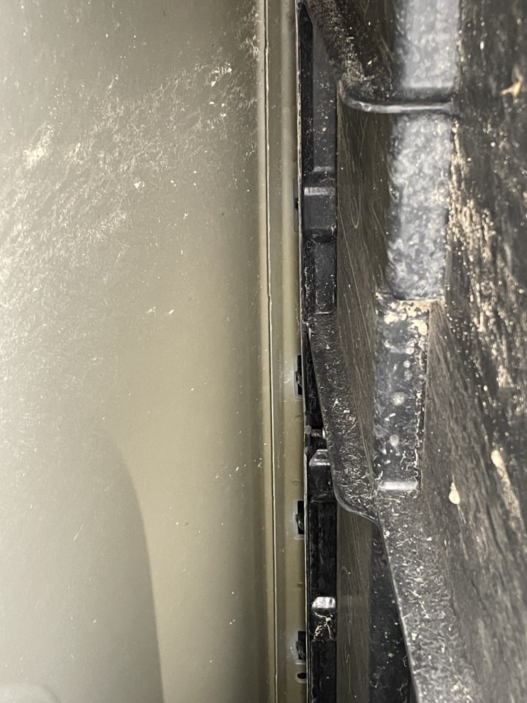

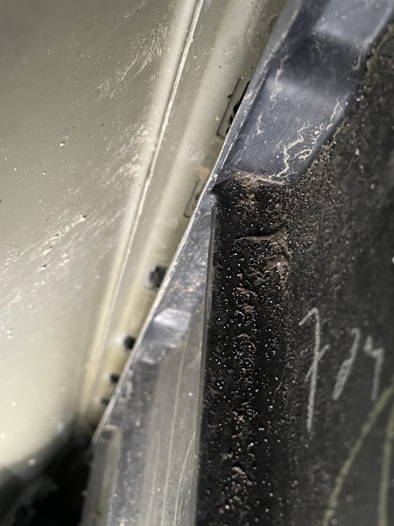

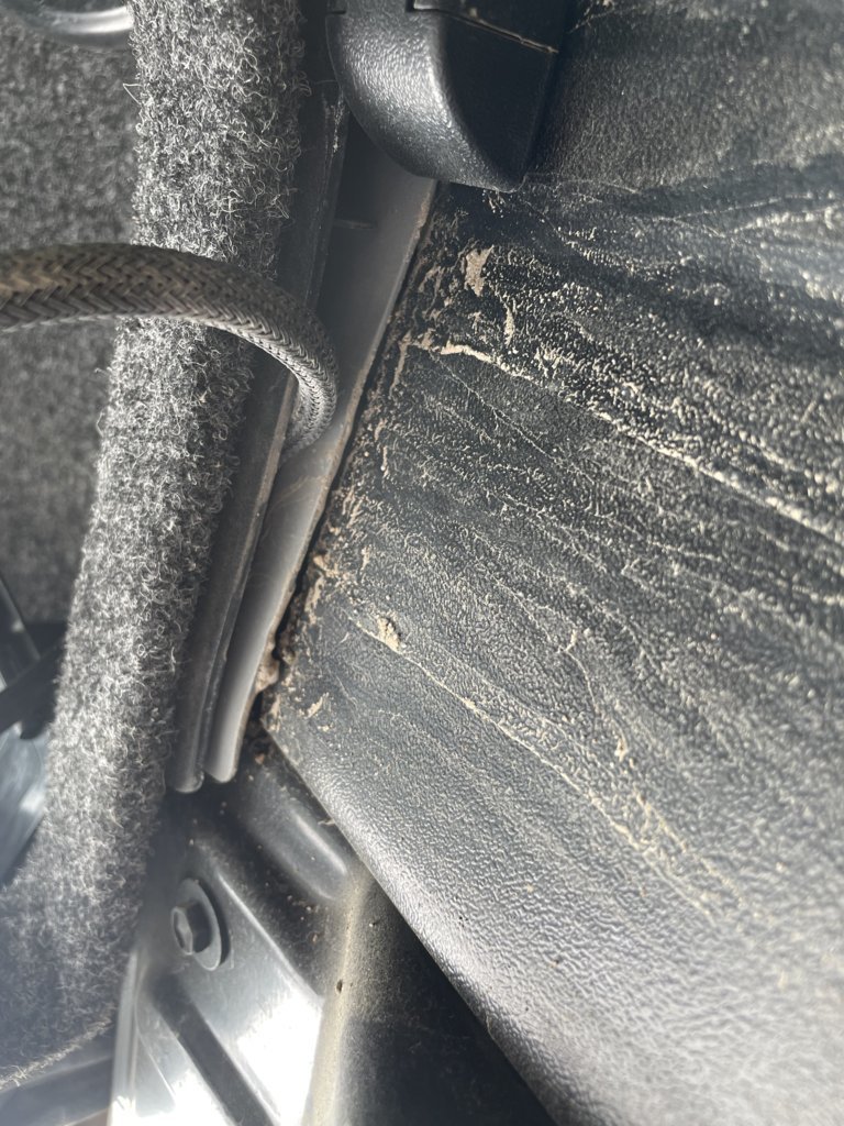

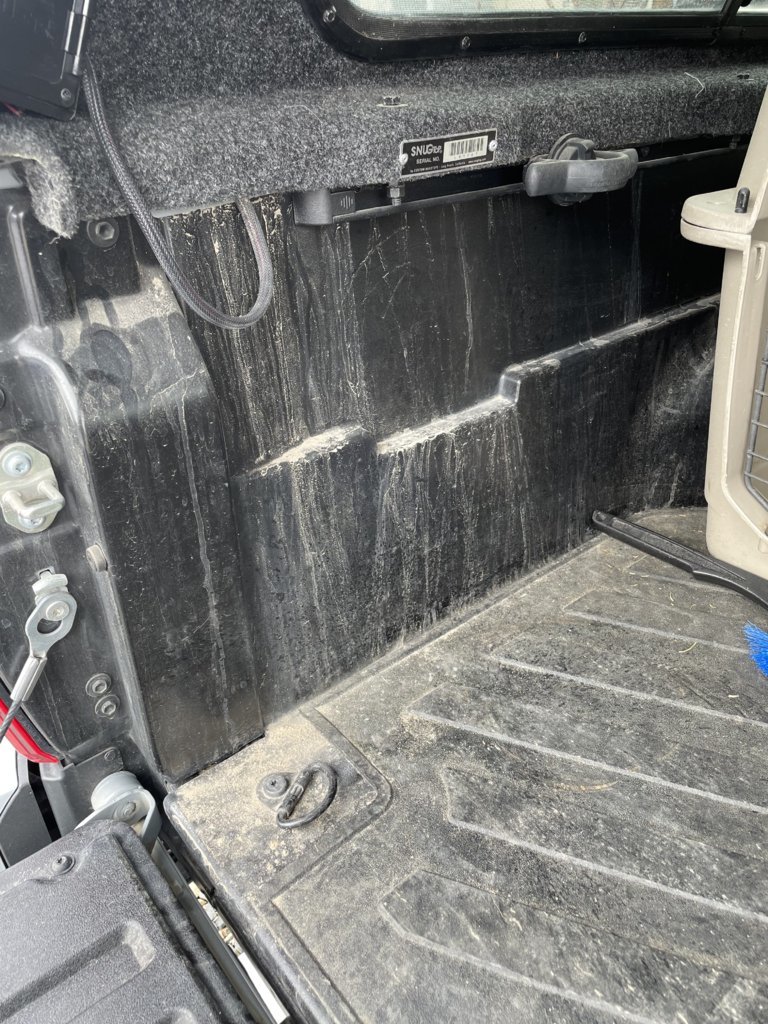

    All the crap that gets kicked up goes between the composite bed and the fender. I know it’s a normal thing on these trucks, I’ll probably take the topper off and seal it all up. IMG_5706.jpg IMG_5707.jpg

    That’s a losing battle I’m afraid. I have a soft tonneau but just accept that the bed isn’t water proof. Idk about the wheels being a source of water in there, but there’s lots of posts about people trying to waterproof the area
    edit: ooohhhh I appreciate those pics!! I see what you mean now! I was trying to imagine how water from the wheel wells would get in the bed. I still get those streaks but never seen them that bad.
    I’m actually planning on cutting some plastic sheeting to bridge the gap from the well liners to my bumper, because my aftermarket rear bumper leaves my BSM exposed from the back. I imagine that would cut down on the spray that gets up in the quarter panel and drips through the bed rail.

    It’s pretty bad, I’ve owned the truck since new and it’s always been that way on the left side. The right side really doesn’t do it much for what ever reason. I know it’s a truck and not an SUV but having the bed somewhat dry would be nice. I’ll probably pull it apart and seal it up at some point.

    What you are seeing there is that there is no seal between the composite bed and the metal fenders.
    The possible leak points are of course your supplied topper, the plastic bedrails on top of the Swiss cheese metal bed rails and the lack of any sealing to the composite bed. All must be sealed for a reasonably dry bed. The stock fender liners do an adequate job, but they do not extend to the rear corners.
