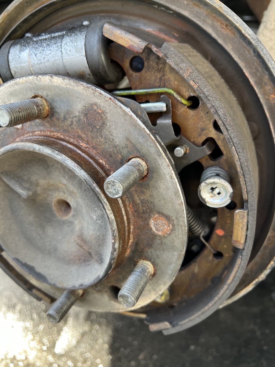

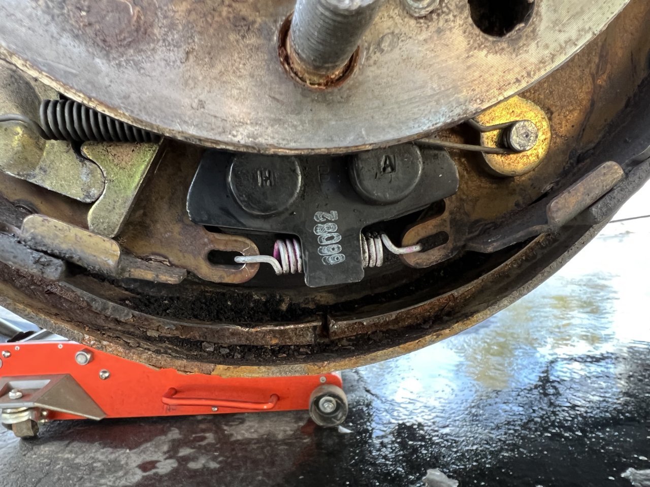

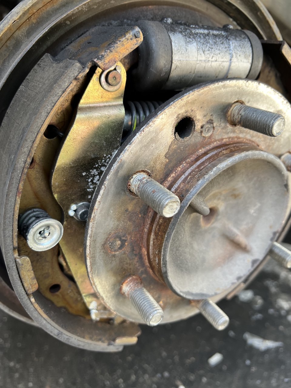

  18. Feb 1, 2022 at 4:23 PM
    #38
    Dianna
    Dianna [OP] Well-Known Member
    May 28, 2010
    #37965
    313
    Dianna
    Ohio
    -06 Tacoma Sport -77 FJ40 -14 4Runner Trail Premium -19 Tacoma TRD Sport Cement Gray
    Update, it was a balmy 40 degrees here so I was able to pull the drums off. The side that was locked up looked perfect but it did look like a chunk of shoe was missing from the top of the rear shoe. The other side appears to have a very slow leak because the dust appeared to have some moisture in it. I am going to make a new post asking about that, how to tell if the rear seal or a wheel cylinder is leaking. After putting everything back together and taking a ride around the block, it seems fine now. I'm still baffled about the issue with the front but at least I can drive it to the dealer now for them to diagnose. Thanks to everyone for the help.

  19. Feb 1, 2022 at 8:00 PM
    #39
    Jimmyh
    Jimmyh Well-Known Member
    May 16, 2012
    #78991
    14,276
    SC
    2012 Prerunner SR5
    I've never seen a shoe lining break off like that.
    Weird.
  20. Feb 1, 2022 at 8:18 PM
    #40
    b_r_o
    b_r_o Gnar doggy
    Nov 17, 2016
    #202672
    14,509
    Alex
    WA
    2015 DCLB
    Are you sure nothing fell out when the drum came off? Something could have been jammed against that shoe and chipped off the piece of friction material.
    What about the smoking front left? Is that still happening?
