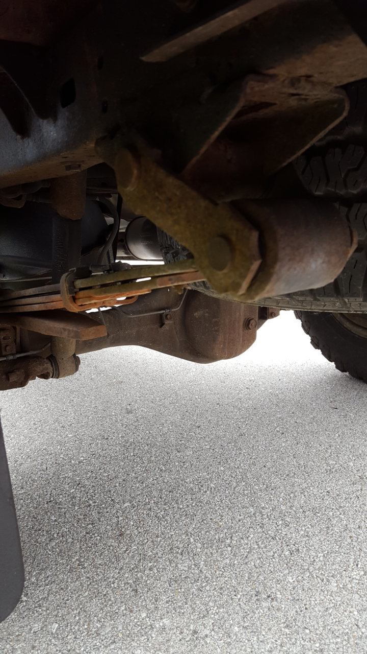

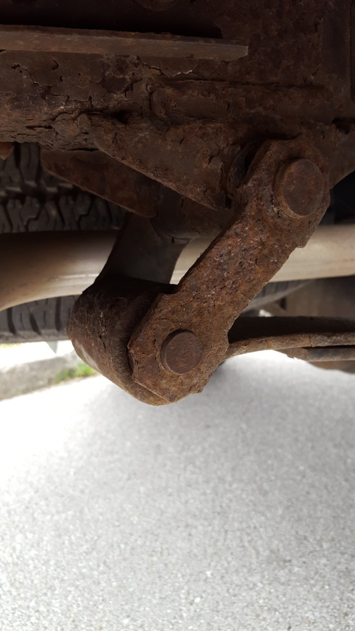

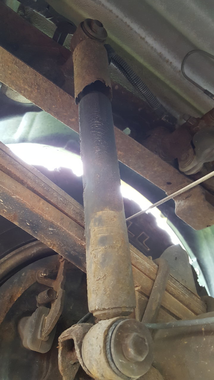

    Looks like my rear shock is overly compressed on the drivers side, maybe that's what's causing the wheel to set back further? Here are pics of the right side, which seems pretty centered.

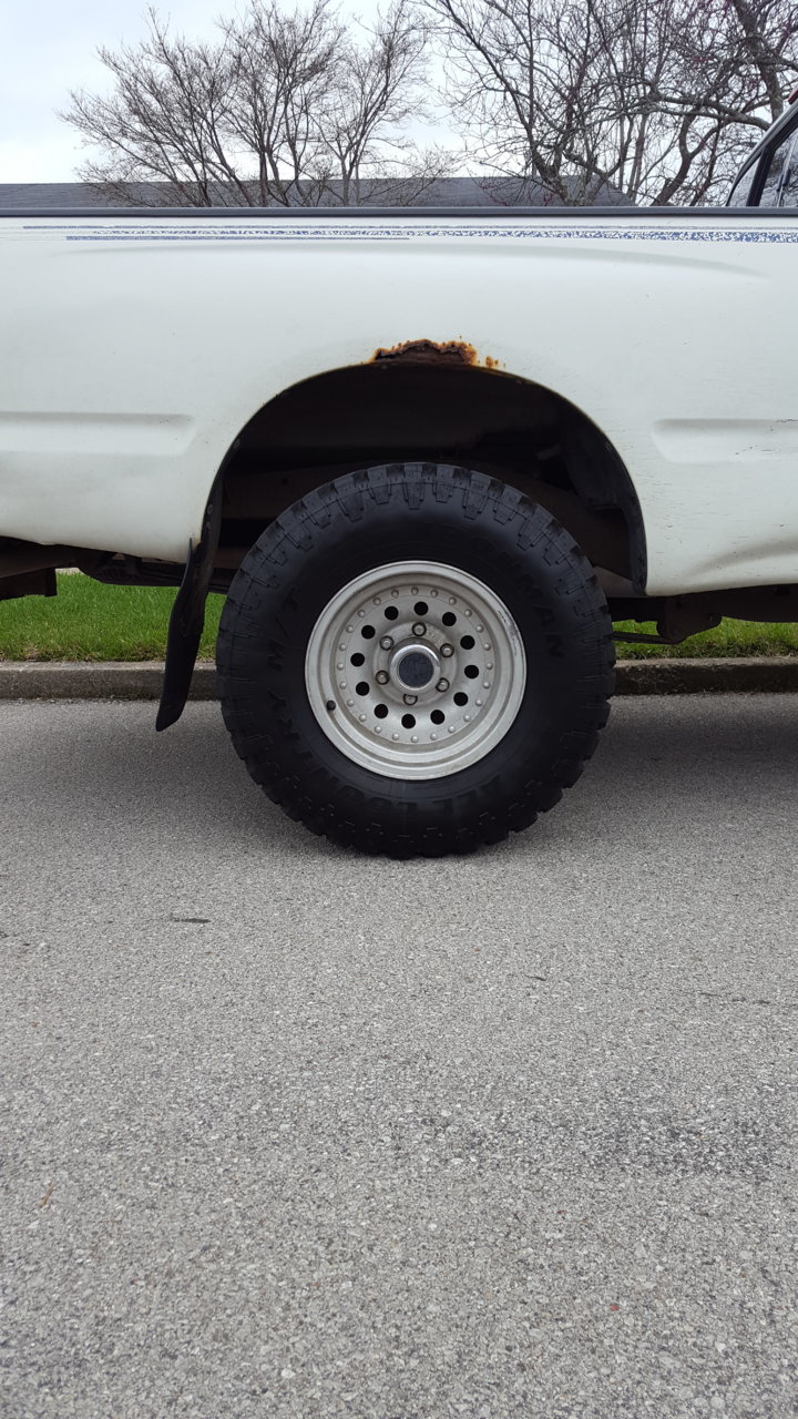

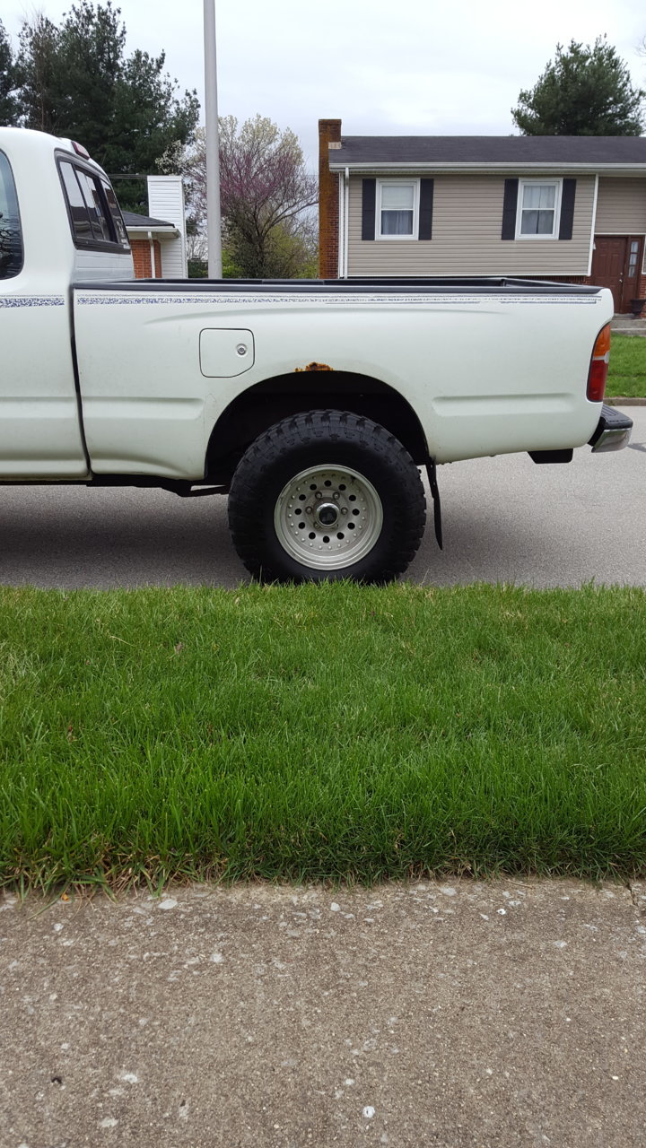

    Here is the left, which is noticeably more toward the back of the wheelwell

    The shocks do not locate the rear axle. The leaf springs do.
    Rather than trusting your eye, I suggest measuring the location of rear axle on each side. Maybe someone with more experience could chime in, but I think you could measure the distance from the center of the front hub to the center of the rear hub. That or some point on the frame to the axle on each side.
    Why do think your leaf springs are shot? They aren’t a wear item, but they have been known to crack and rust.

    If you look at rear the leaf attachment point on the passanger, the leaf springs look to be bent down slightly compared to the drivers side.

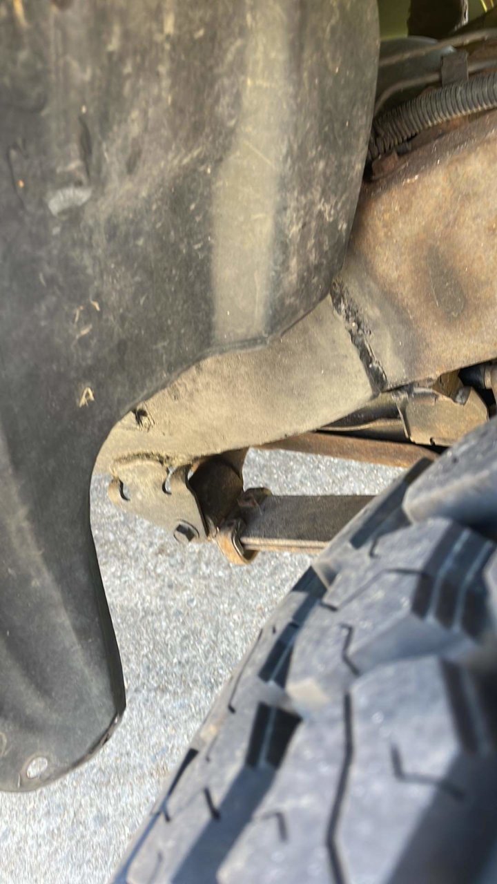

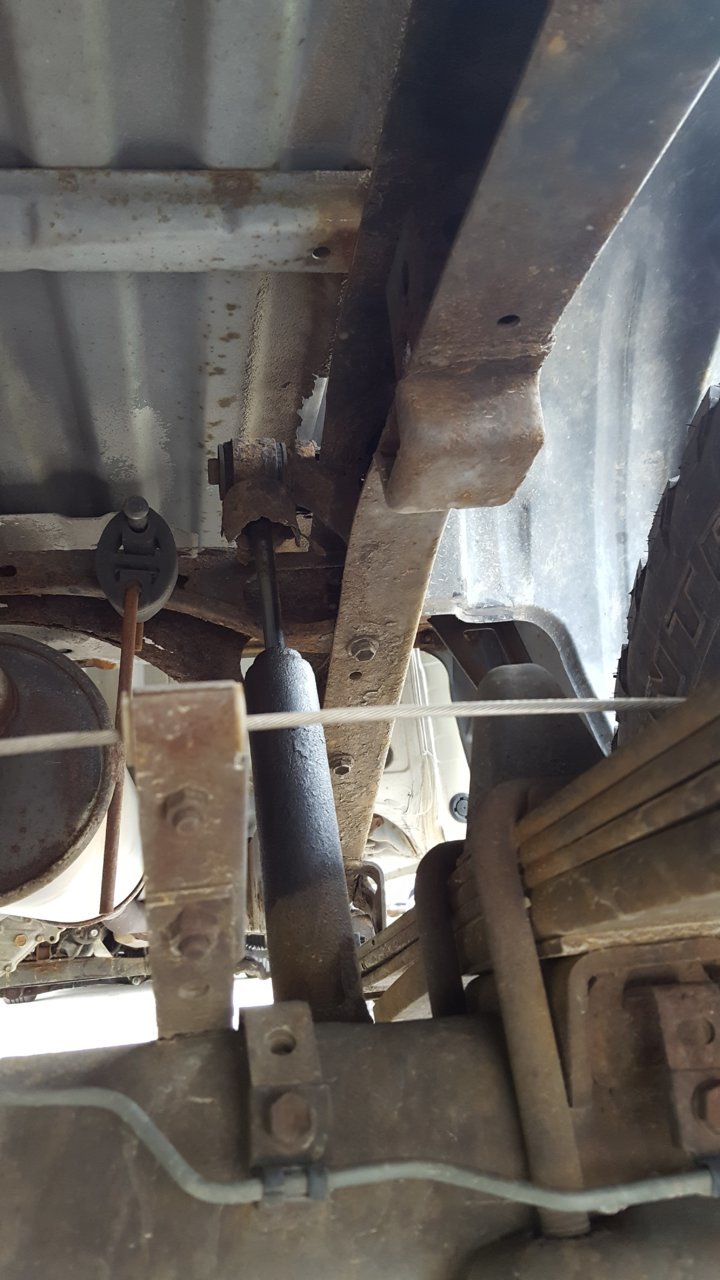

    Update, frame repair on drivers side added material to bottom and side of frame, front leaf bracket sits lower and maybe further out, so wheel is pushed back.
    Question.
    How bad is this for my vehicle? Plan is to have old fix cut out and add saf t cap to that area. Rest of frame seems to be solid.

    Probably just dog walks a little bit. Fixs are: Redo the whole frame fix or ever so slightly move that leaf hanger forward

    Appreciate the feedback, I'll likely just get the hanger moved for now!
