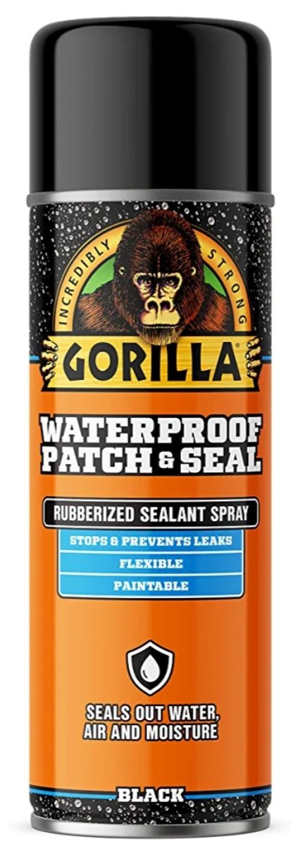

    I use Gorilla waterproof patch and seal, which I liked, but it goes on black.
