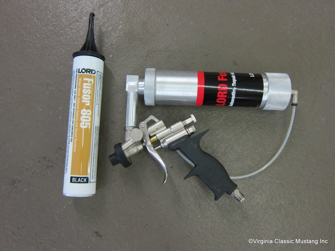

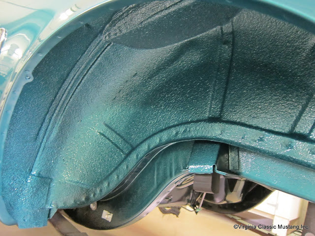

    It's Lord Fusor 805 with a Lord Fusor pressure pot gun. The classic Mustang guys do this to there rear wheel wells and paint and clear it.
    I did it to the 69 Mustang I restored and I can tell you it looks the same as the Tacoma's coating.
