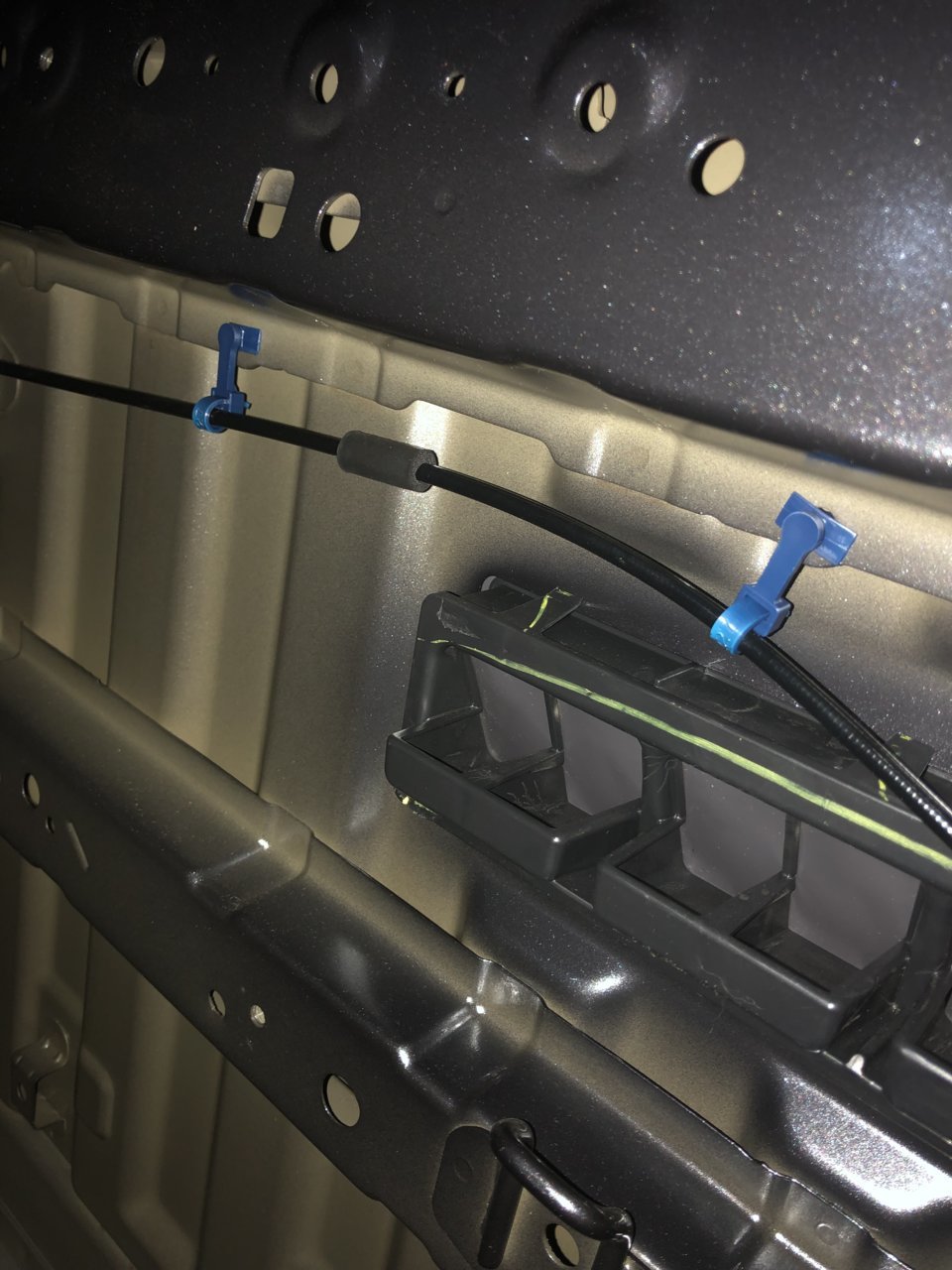

    Don't know if you fixed your problem or not but I think I solved the rear sliding window rattle in my truck so I thought I'd share in case it helped you.
    I took out the rear storage bins and pulled the insulation panel out from behind the rear seats. The cable that runs the sliding window hangs in place with zip tie style clips that clip into the rear body panel of the cab. The zip ties were only loosely holding the cable so when the rear slider is open and the tension is taken off the cable it just flops around in there. I tightened the zip ties as tight as they would go and trimmed the excess off and I don't hear the rattle anymore. I'll include a picture. The blue zip ties are what I tightened to fix my rattle.
    Edit: I know it doesn't seem like that cable would make enough noise to be the problem but it was so loose with the window opened that it would bang on the metal of the cab as well as the plastic air vent in the back of the cab. I took a drive down a real bad road that would make it rattle before and I didn't hear any noise so cross my fingers hope this is the solution.

    Thanks! I haven't done anything to check on the rattle as to its source, but it is still there. When I get time to start poking around both underneath the truck, and behind the seat I'll definitely check out your solution!

    After driving to work today the rattle is definitely gone. Let me know if this works for you.
