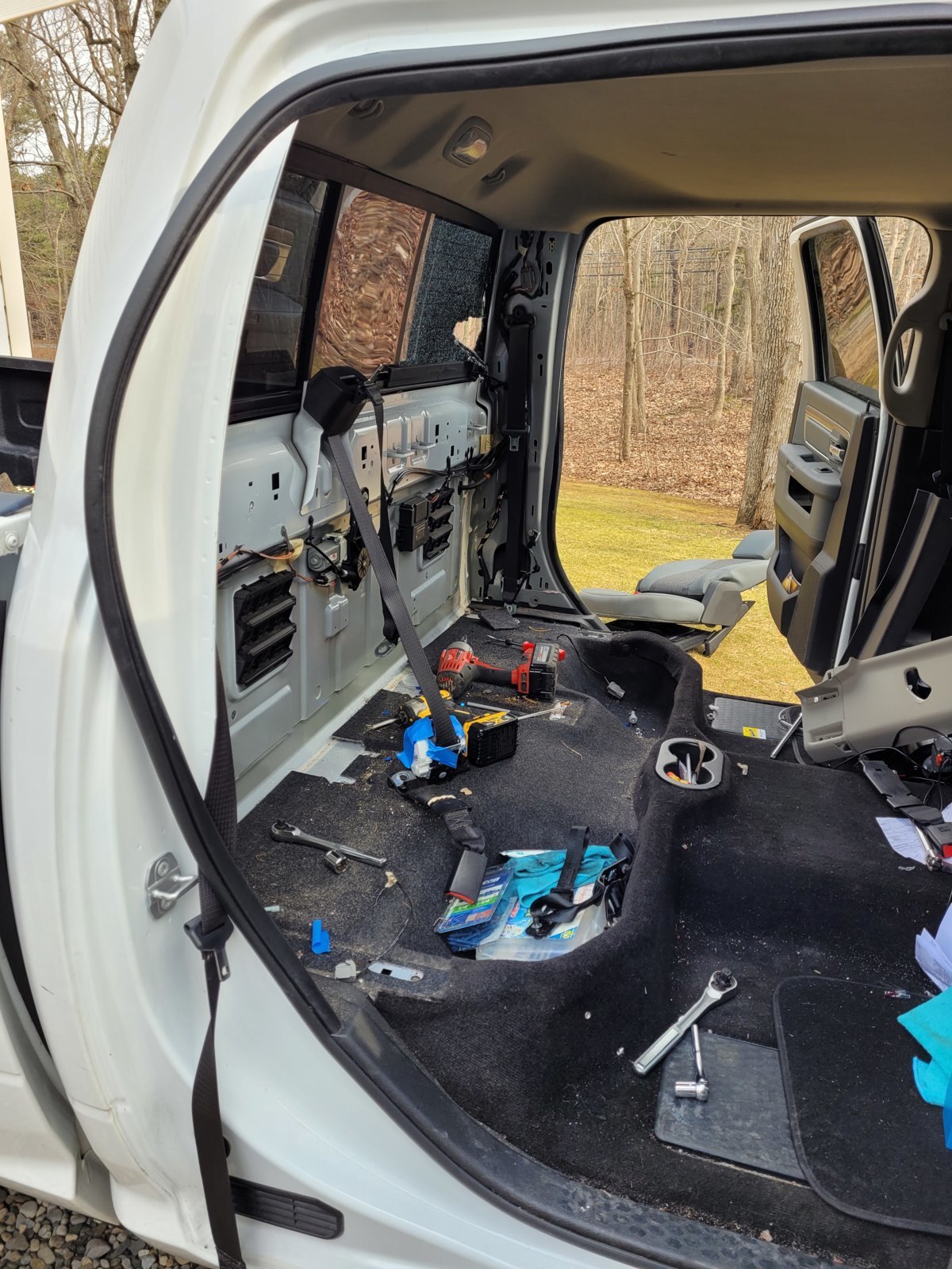

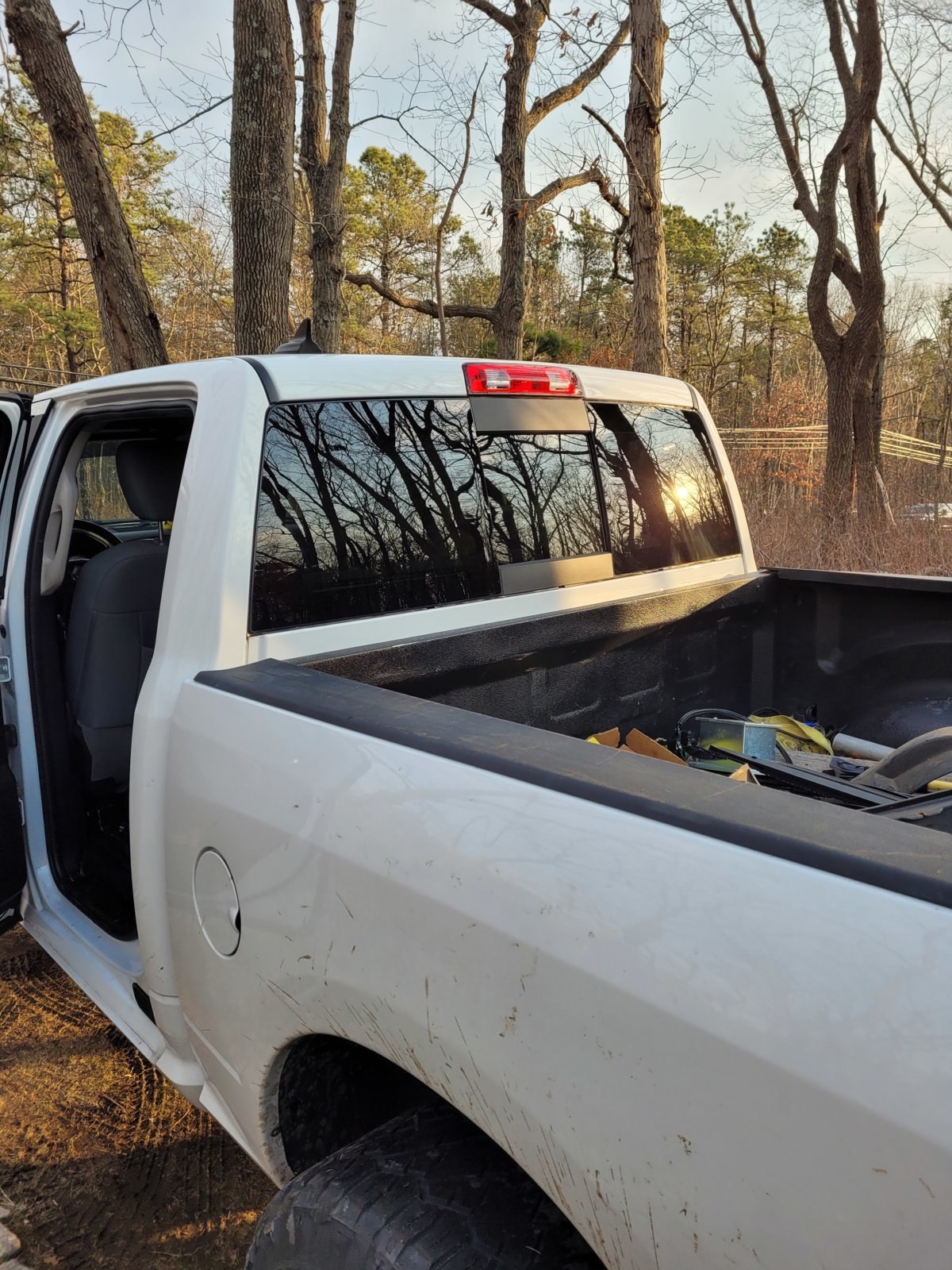

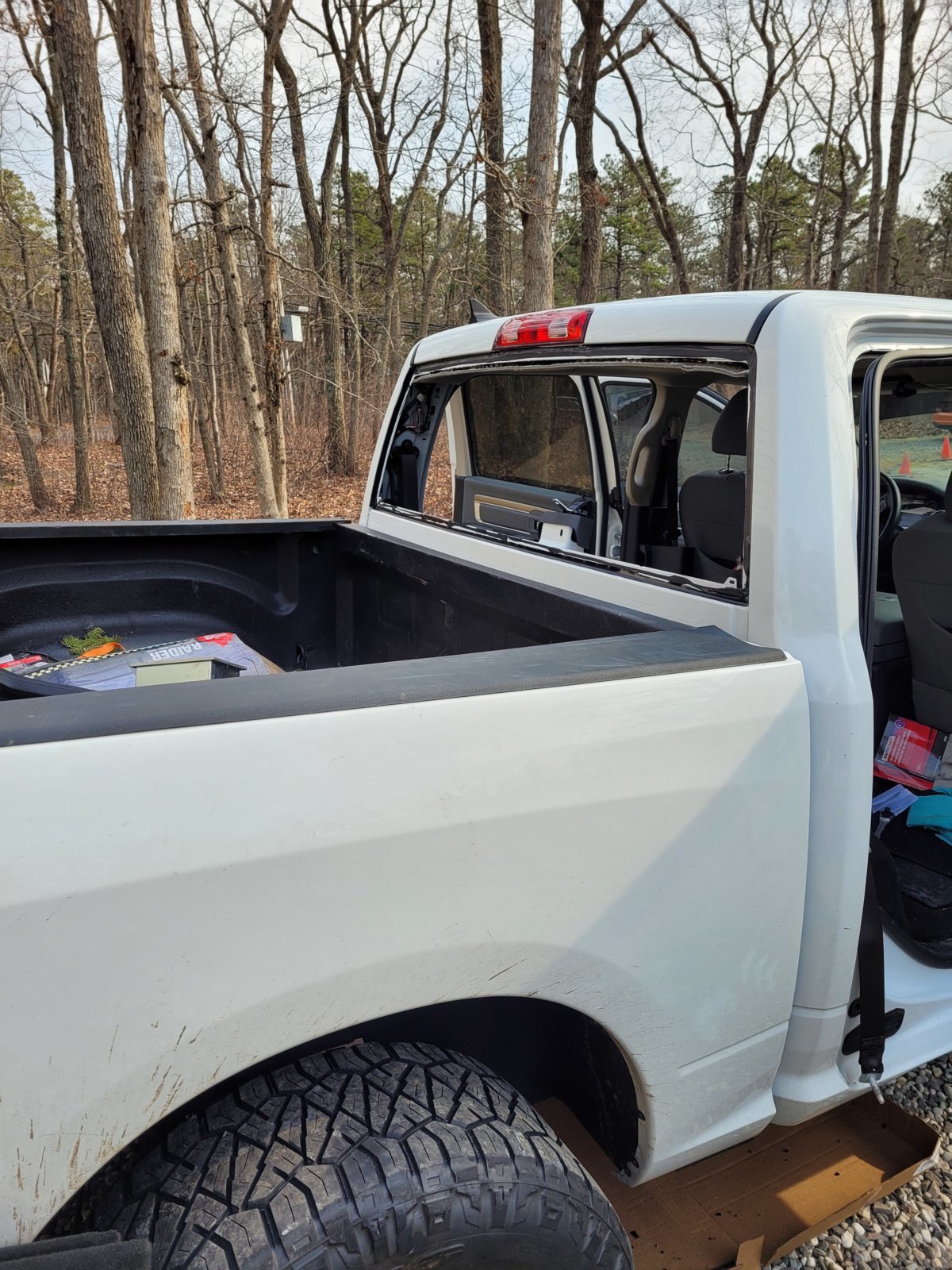

    Tacomas are a cake walk compared to a ram rear power slider. Last picture is finished product. Literally have to remove everything in the back to get to the motor of the power slider. Also was a 1200$ job that was including the oem backglass.
