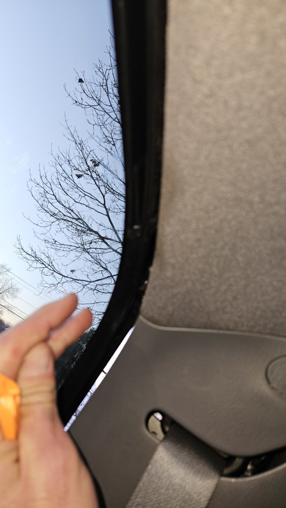

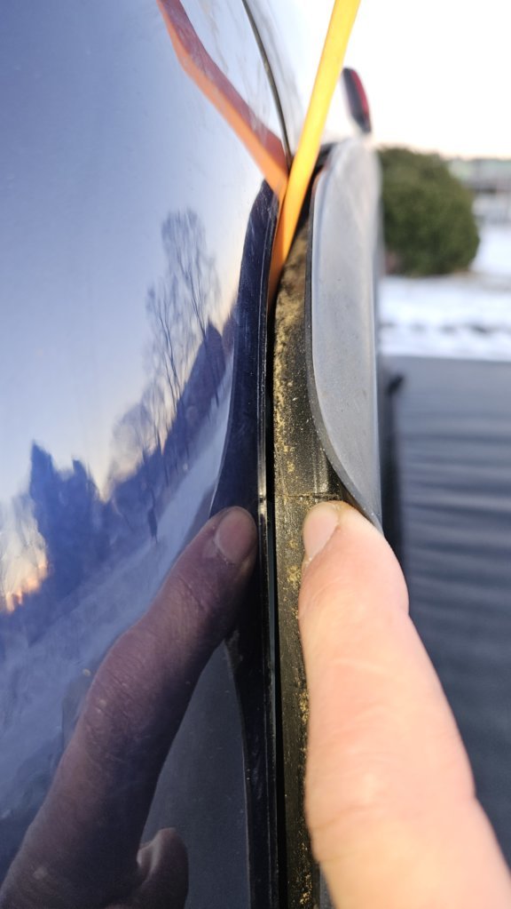

    I recently bought a 2013 SR5 4x4 access cab (64k miles). It's in great condition except the seal or gasket inside the rear window is detaching. The rubber flashing/trim around the perimeter of the window is in good shape and intact, it's not dry rotted or cracked in any way.
    Obviously this is a pretty significant problem. The window can now be pulled outward, away from the cab, about 3/4", and you can see clear into the interior through the gap.
    I can't find a part number for a gasket, it seems that the entire OEM window assembly is sold as one part.
    The failure seems to be mostly in the driver's side top corner, but I imagine that it's only going to continue if I don't address it.
    Can I just carefully inject a thick bead of silicone under the rubber flashing to reseal the window?
    Do I need to order and replace the entire window ($$$) ?
    I've searched the forum and looked through a couple threads but there aren't great suggestions and most OPs never return to the thread AFAICT.
    I really like this truck, I saved up and shopped for several months before I bought it because it's in great shape with low milage and the frame is very good for a New England truck. Just need to get this sorted before too long.

    Go to an automotive glass shop. They should be able to inject a bead of butyl adhesive sealant in there (like the stuff used to hold the windshield down).

    Thanks, that's helpful! I'll try a couple local places before I get in there with the 3M.
    From the other, similar, threads here, it seemed like auto glass shops didn't want to touch a window except to replace it entirely, but it can't hurt to ask.

    Update: I find a local shop who pulled the window and remounted it with fresh gasket and adhesive. It was only a few hundred, he did professional work and didn't try to sell me a new window.
    I had done a bunch of reading and watched a handful of videos and it seemed like there was a good chance I might not do a clean and thorough job with the adhesive and gasket, and there seemed to be some chance that I would break the window which would instantly cancel or any savings from doing it myself. YMMV.
