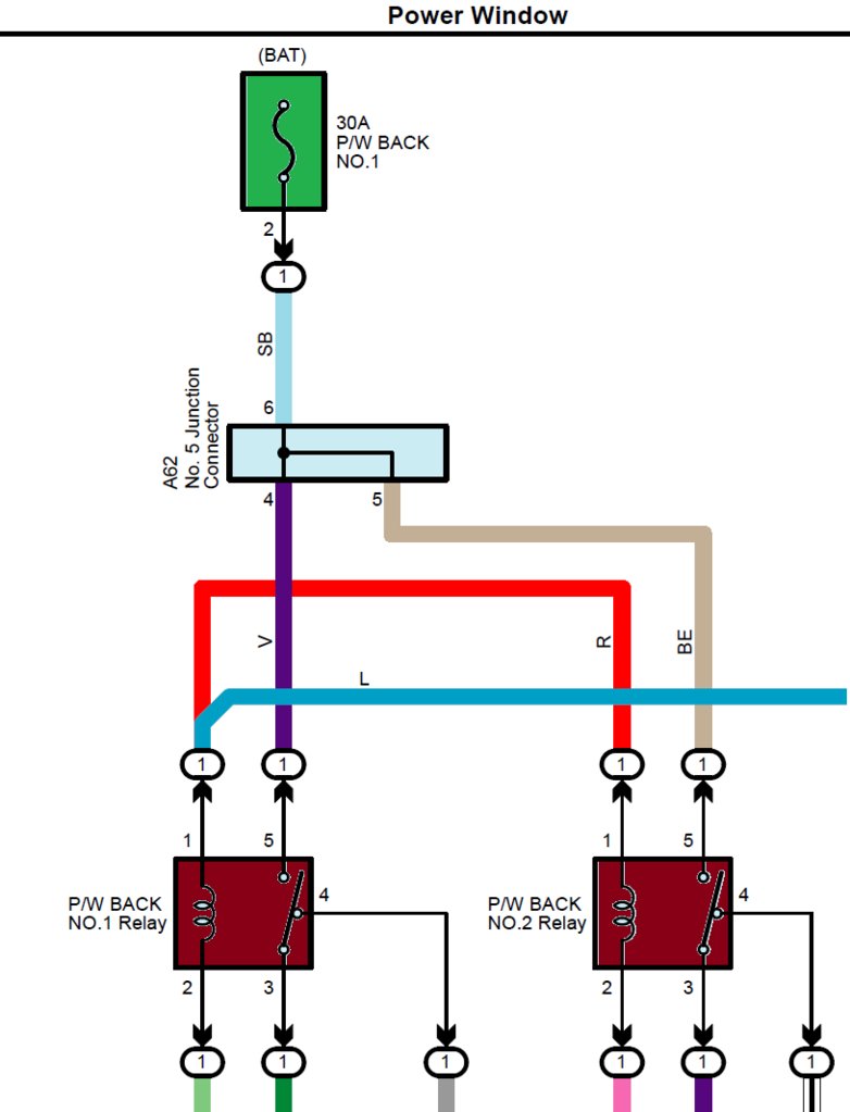

    OP, do you have the relays installed?
    Stevie17 likes this.

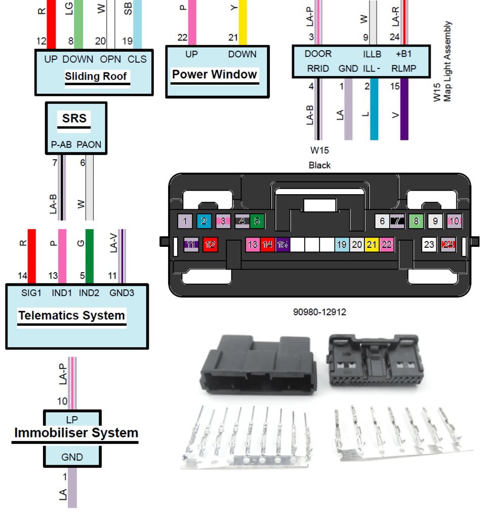

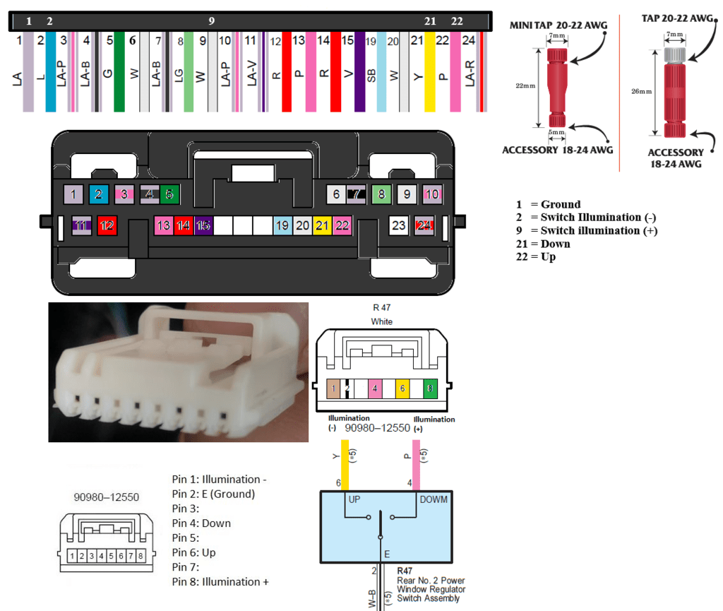

    Another option to add the switch is tapping the wires at the overhead console (W15) and running them to where you've chosen to install the switch. Purchasing the MESO map light add harness would make an easy location to tap them without going into the vehicle harness.

    Or this:
    Posi-tap the wires to the window control switch.

    Just looked, no relays for the rear window.
    yea the whole console is expensive. Looks like the majority including the circuit board may be the same on all of them but the faceplate that holds the switch in place is different and doesn’t appear to be available. I’m sure I could get one made up with all the 3D printing shops now but I’d have to come up with a model or part to copy. The switch also looks different than the 3rd gen’s that I see available, to fit in the overhead console “tray” under the faceplate and contact the circuit board solder points which I am guessing is how it works as I don’t see any wires in the overhead console disassembly videos I’ve seen where the switch is there.

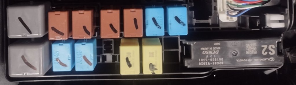

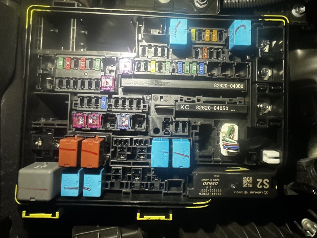

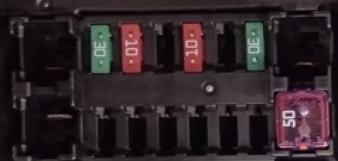

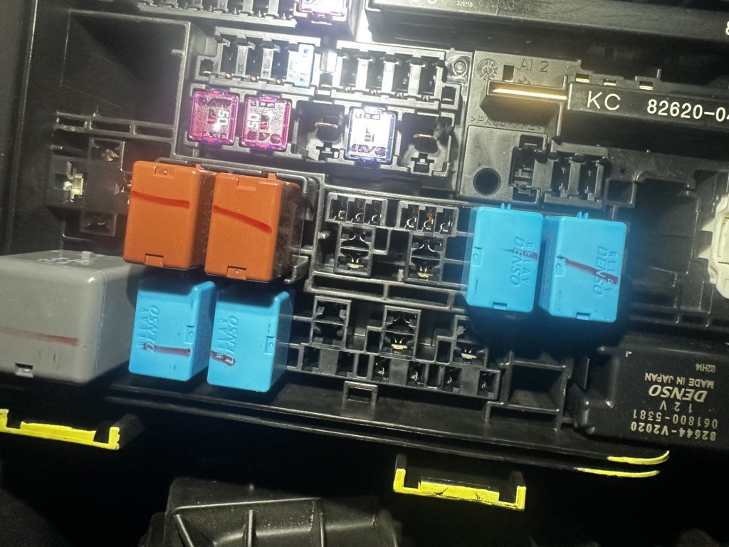

    The spot where the relays are missing, do they have the terminals?
    Like so:
  16. Oct 26, 2024 at 4:49 PM
    #36
    nafischer90
    nafischer90 [OP] Active Member
    Nov 2, 2018
    #271384
    36
    Nick
    2018 TRD Off-Road DCLB

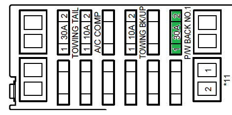

    They do have terminals. And it looks like the 30A fuze is there as well.

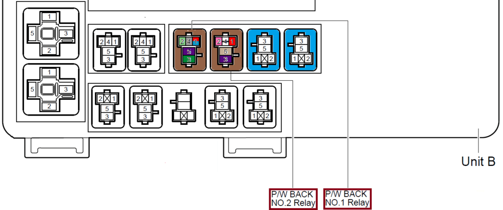

    Are relays generic? I’m not having any luck searching for “rear window relay” or anything similar. Do the colors signify anything? I may have better luck searching for a PN, tomorrow I could pull one of the brown ones

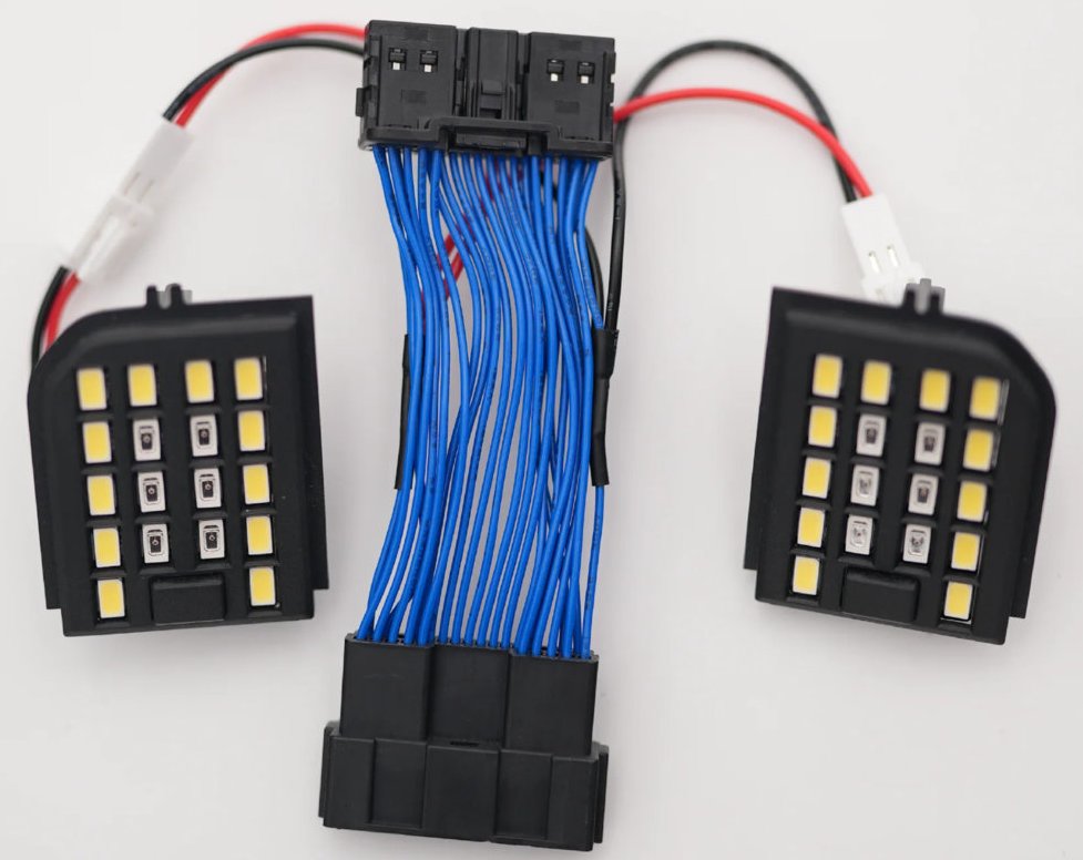

    I w
    as actually just looking at these yesterday when I disassembled the overhead console. Do you have them? The stock lights are pretty pitiful and after the disassembly I see why, it’s just a couple of small LEDs on the circuit board with clear plastic to transfer the light up like a fiber optic.
  20. Oct 26, 2024 at 5:17 PM
    #40
    caribe makaira
    caribe makaira Well-Known Member
    Feb 13, 2011
    #51121
    11,781
    Caribbean, Puerto Rico
    05 PreRunner TRD Offroad AutoTrans
    Hood Struts, My version Fogs always ON, Map & Overhead Light Mod,
    Very bright substitutes...and red or white choice in same assembly.
