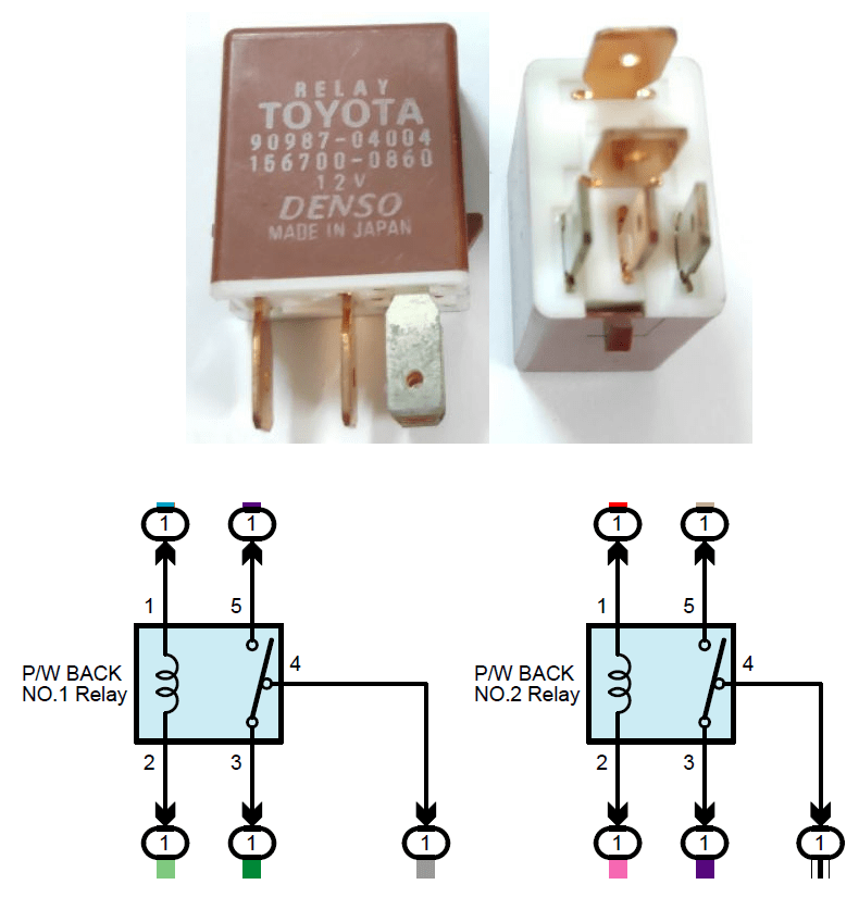

    I made a mistake on the type of relay missing, they should be the reddish/Brownish ones, since they need to have 5 pins, not 4.

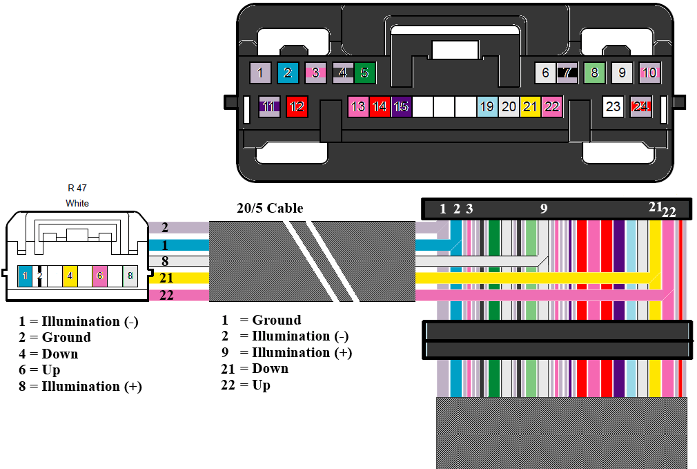

    Tie into MESO (or assembled by others) Map LED harness.
    20 awg wire (x5) cable to Rear Sliding Window switch (R47), long enough to reach desired switch location.

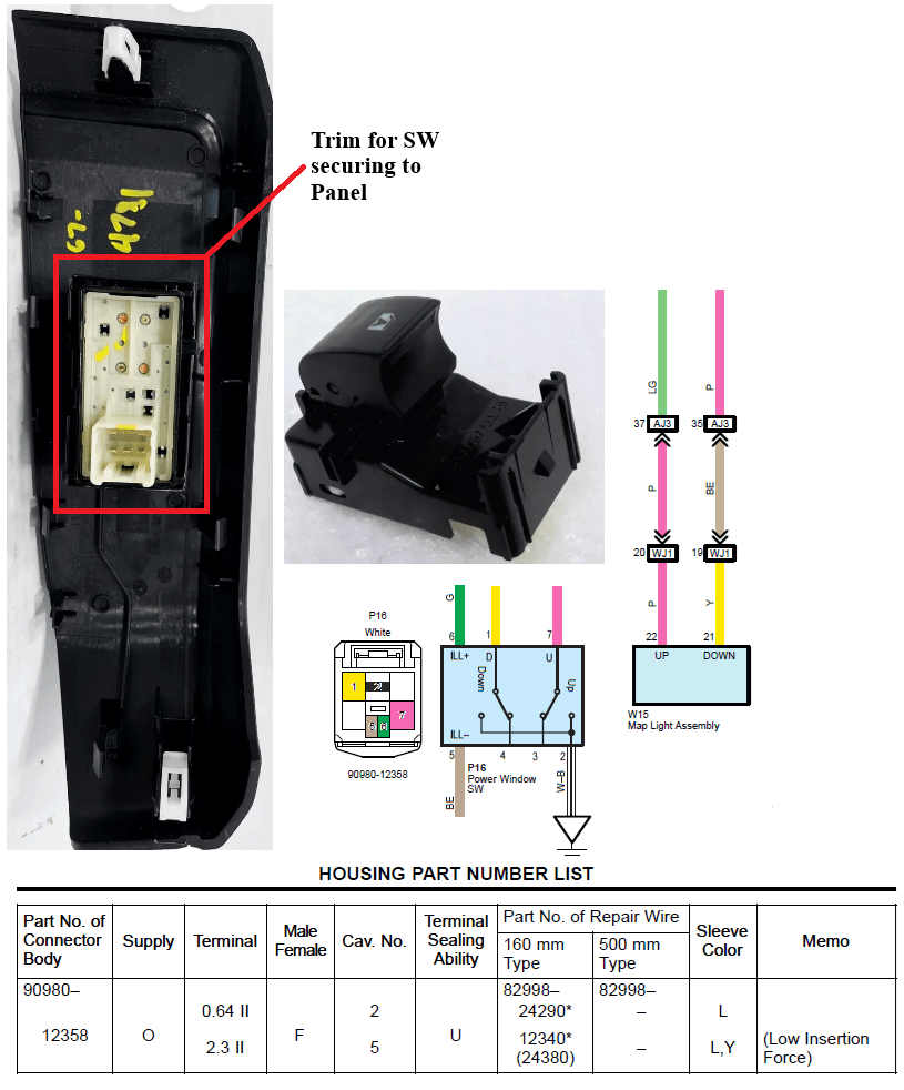

    Another option:
    Purchase the rear door window switch of a 3rd Gen along with the switch panel. Trim and glue the panel to fit through the center panel forward of the shifter. Since your Taco has no Cellphone charger panel, it'll be an easy fit. Purchase the window switch and connector also. Wire it up and mate, place in modified switch holder.

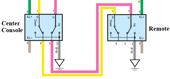

    Dual 3rd Gen switches add-

    My list of required parts:
    Overhead console 63650-AK050-C1
    -$260, i can’t find a 2024 switch but if I use a 3rd gen one and relocate I’d probably be looking at $100 for a switch and 3D printed holder.
    Rear window - $300
    Window motor I believe this is PN 69807-0C100, on the dealership/parts websites it says these are tundra but the diagram shows the Tacoma assembly so I’m guessing it’s the same motor. Need to confirm - $212. Likely could use another motor and modify but would take some engineering
    Relays 90987-04004 - $20-40 for two

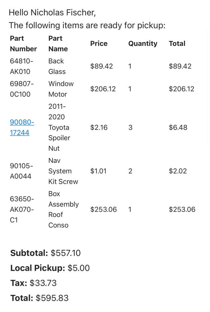

    Update, I ordered all of the parts and just picked them up at the dealership. The solid glass back window is on back order and unavailable so that sort of made the decision as I would have been without a window this winter if I didn’t get a slider. They also must have a price mistake in the Toyota system as the heated sliding window was $89.42 while the solid window that I can’t get was around $200. I ended up just buying a whole new overhead console which was the most expensive item but I figured by the time I got a switch and tapped into the harness and made it look good I would be spending a chunk anyway and it wouldn’t be as seamless. Attached are the Toyota parts. The only other item I needed were the two relays but ordered them off eBay for $12 for two instead of buying new ones for $54 each from Toyota. Making grand total in parts after tax $608. Test fit the motor and it mounts right up to the 3 studs in the back panel and plugs into the existing harness connection. I’ll be getting the window installed tomorrow or this weekend hopefully and will post an update once I have the relays.
    Edit: The relay Pn is 90084-98032 in case anyone stumbles in this post in the future and trying to do the same thing. 2 are required.

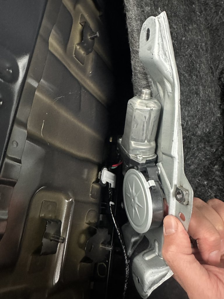

    2018 TRD Off-Road DCLB
    So I got the new glass installed and everything fits up with the
    Motor, the new console with a switch and relays but the window doesn't slide. I'm going to try to do a deeper dive into the wiring to verify everything but from what I could tell all the correct wires are there and it should be physically good to go. I'm wondering if there is a chance there is something in the computer software that needs to be updated? The items in the circuit are the motor itself, the switch, two relays and a 30a fuse wich are all there now.
