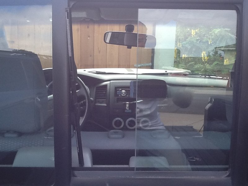

    I expect I am not the first. The vertical plastic strip on the left side back glass edge that the slider latch hooks to, fell off. Looking at it, it really looks like a crappy cheap design, so I guess this is not surprising. Has there been a fix engineered here that stays in place? image.jpg

    I used two part epoxy..then left it clamped for24hrs.wish I knew the name of product.
    First attempt failed.. so I got glass specific two part epoxy.
