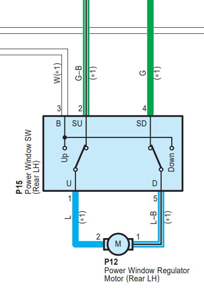

    I'm assuming you checked the D RR P/W (20A) and P RR P/W (20A) fuses?
    Do the windows not work from the switches on the doors either?

    Then you need to check for power and ground at the switches.
    With both not working, I'd guess the ground side of the Master switch is "bad".
    Pull passenger rear switch out.
    Make sure the window lock is NOT on.
    Turn Key ON.
    Test the following wires:
    Green/Black (Pin 2) and Green (Pin 4) for Ground
    White wire (Pin 3) for Power.
    Dm93 likes this.
