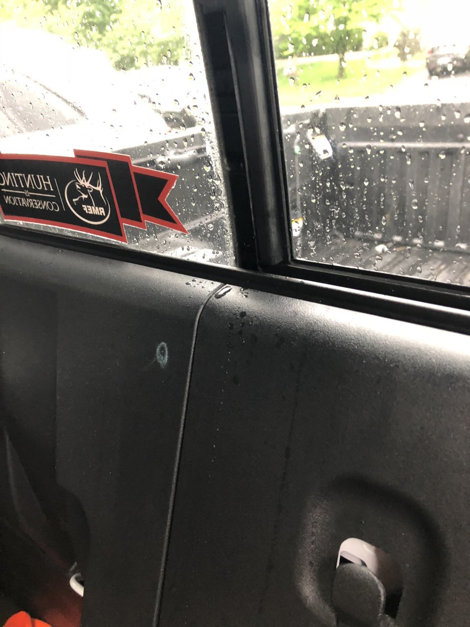

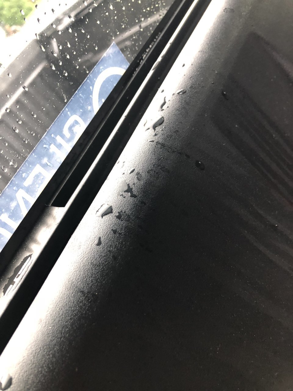

    just saw it here after some heavy rains, it was along the back edge of the entire
    rear window, couldn't find the source and can't imagine it's from the bed light seal
    that most see the issue from - nothing on headliner or anywhere other than the ledge.

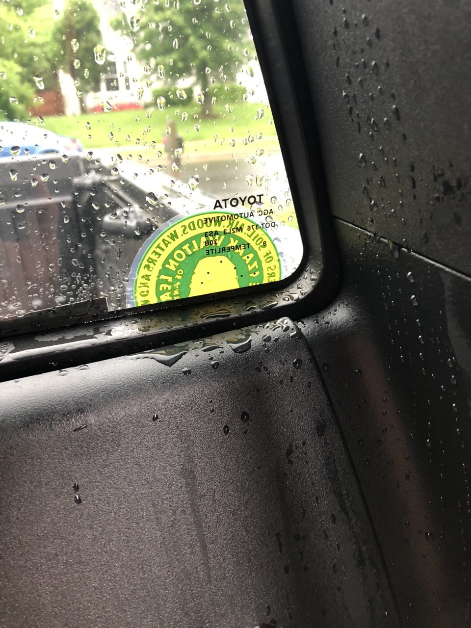

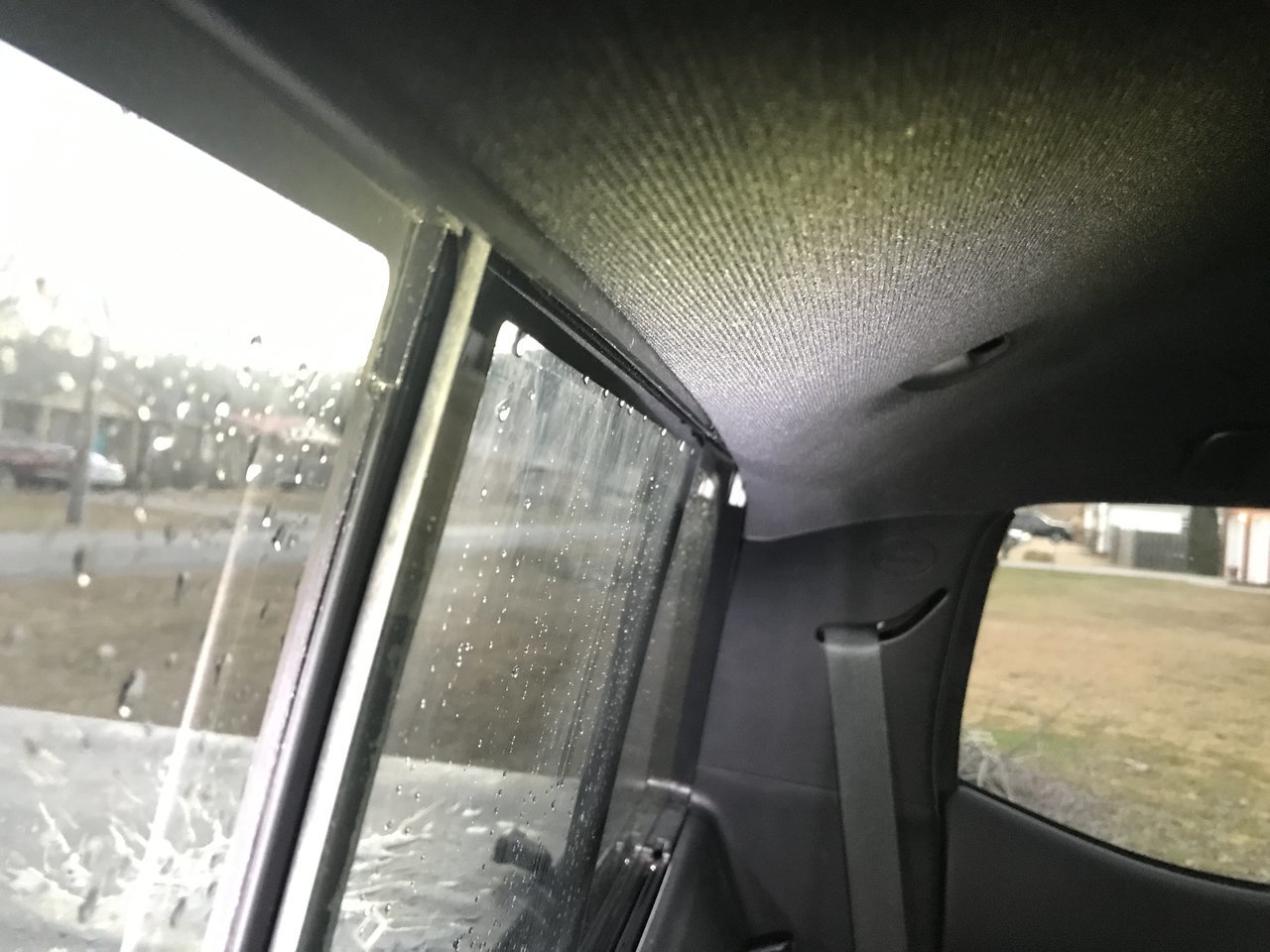

    Monsoon season here too in VA since last Tuesday and my 2016 Tacoma developed a leak through the whole upper portion of the rear windshield. Going service on Monday.

    This is the same issue I have

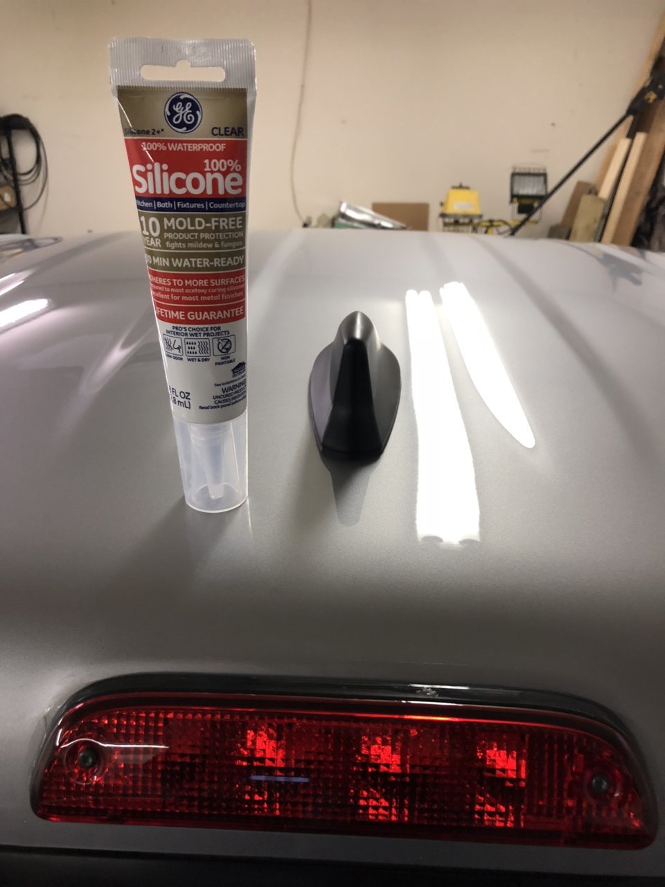

    For the brake light
