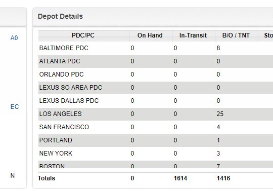

    I called my dealership and told them to order the replacement part and call me when it arrives and then I'll bring my truck down for their "diagnosis". I figured they will be more willing to fix the gasket if they already have the part at the dealership.

    What I was told is that you have to purchase the whole lamp, they don't offer a "gasket". However, there is a nationwide backorker on the lamp assembly (e.g. $150)... and no one is aware of this problem? Pathetic.

    Still on backorder and the current part number is 81570-04050.
