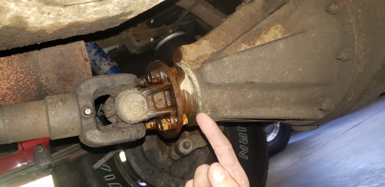

    I have a bit of play in what i think is the yoke going into the rear diff (rear axle from driveshaft) i have new u joints to put in but im 100% certain the play is coming from what i believe is the yoke. Here's a picture...
    So, what is it and how do i fix it? Im wondering if this is a contributing culprit to my vibration issues.
    And, while i have your attention, when i have my clutch pedal to the floor, i still get a jump when shifting from neutral to 1st sometimes. What do you make of that?
    As always, thanks for the advice!!!

    You need to pull the diff and have it repaired. Without the proper tools you cannot do it yourself.
    Consider upgrading to a solid crush sleeve instead of the current setup.
    Improper set pinion will lead to the diff grenading.

    Can you take a video at all of the play? A little is to be expected but more than 1/8" would mean an issue. It does look like your seal is leaking as well unless you sprayed it with something

    Ive tried to post video on here before and it wouldn't let me. I did spray the nuts with pb blaster to replace the u joint. Let me see if i can post a video of the play

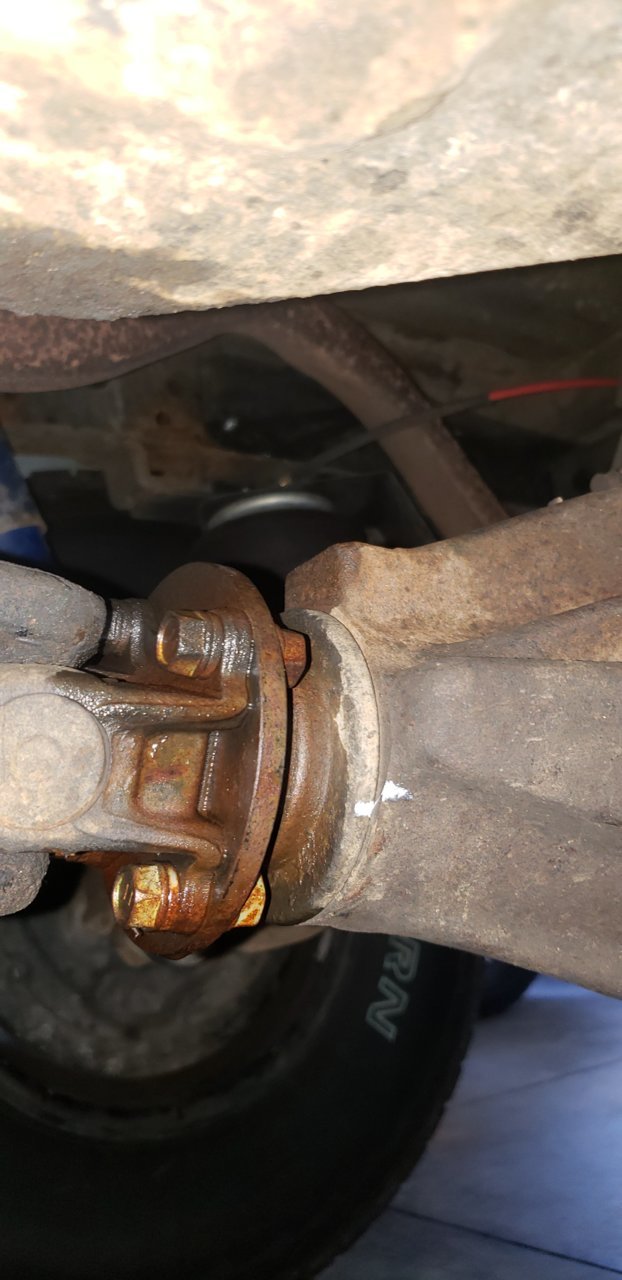

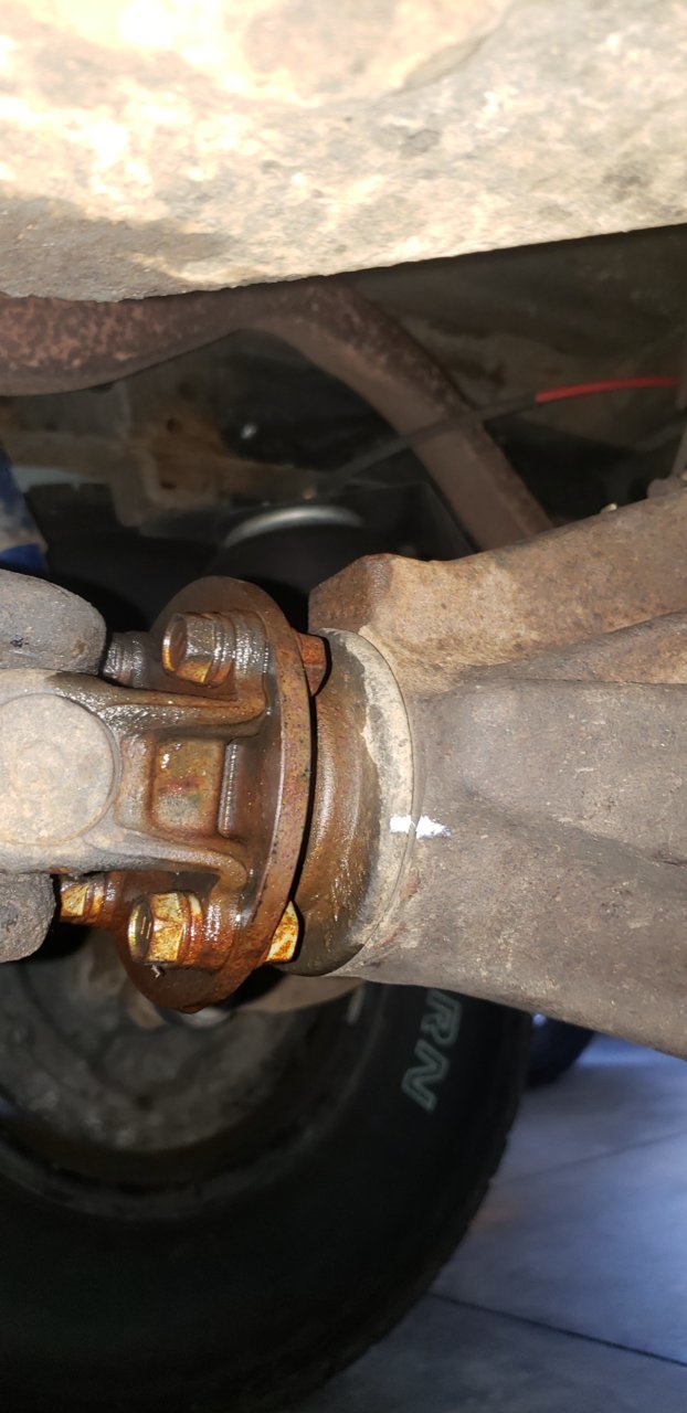

    Straight
    Play

    A shop versed in Tacomas would be your best option, unless you have an incremental dial indicator to measure and adjust the backlash on the pinion gear meeting the ring gear.

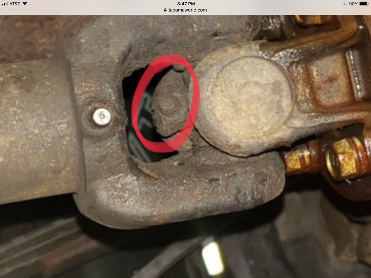

    When did you grease your ujoints last? Looks like a looong time ago.

    pinion movement seems acceptable with the combined backlash of ring gear and spider gears.
    replace the u joints before diving into the differential

    Actually wasn't that long ago. But i literally just wrapped up putting a new one in. I bought the truck off the original owner, my friend. I asked if he had done any interval maintenance, and he said: "i only did what the oil change place said needed to be done" lol.
