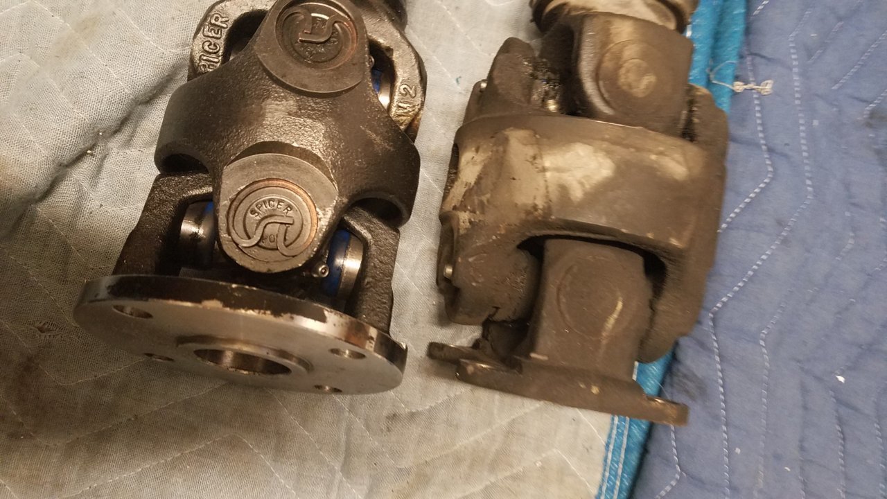

    My driveshaft at 570,000 gave out on me two weeks ago,
    Slip yoke was making all types of ping noises and ujoints were having 1/8” play and Cardan
    joint was not looking good either. From all I could research for repairs it looked cheaper to just get
    a new driveshaft with all spicer components, Cardan joint, ujoints, shafts all made by Spicer and balanced for 480.00 shipped.
    Toyota said the OEM Cardan joint was not replaceable and no part number for that joint.
    So far all is good
    https://www.wholesaleimportparts.com/Toyota_Tacoma_Driveshaft_1997.php

    Lol, I must be a genius because nobody ever taught me to tear down double cadian joints but I taught myself, and had many driveshaft shops tell me it’s a hard job for them. I give you your respect and I do more than just driveshaft 101. I’ve built many toyota showtrucks and am a Orange level certified KTM tech and worked with Kurt Casselli, and Dave Pearson so just let respect meet respect. We truly all have different ways to the finish line I like mine better personally thats all. But I am a 40 year old stubborn mechanic that has it in blood, since I was ten fixing the neighborhood’s bicycles till now. BTW my driveshaft was custom made by Driveshaft Specialties and is pretty rare because for 2wd they are harder to balance a 70” plus shaft, which you probably know, and hardly anyone wanted to make it because they lacked the equipment to balance it. This was the perfect fix for all my vibes being lifted after exhausting all resources to not replace it, I tried every stupid trick and smart one in the book, lol. Woods won’t touch a one piece for 2wd btw.

    C a r d a n joint. No one seems to know how to spell it.
