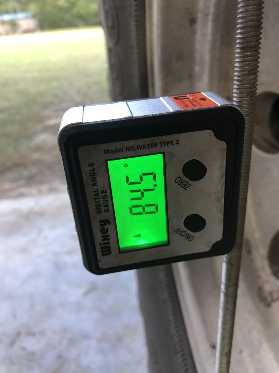

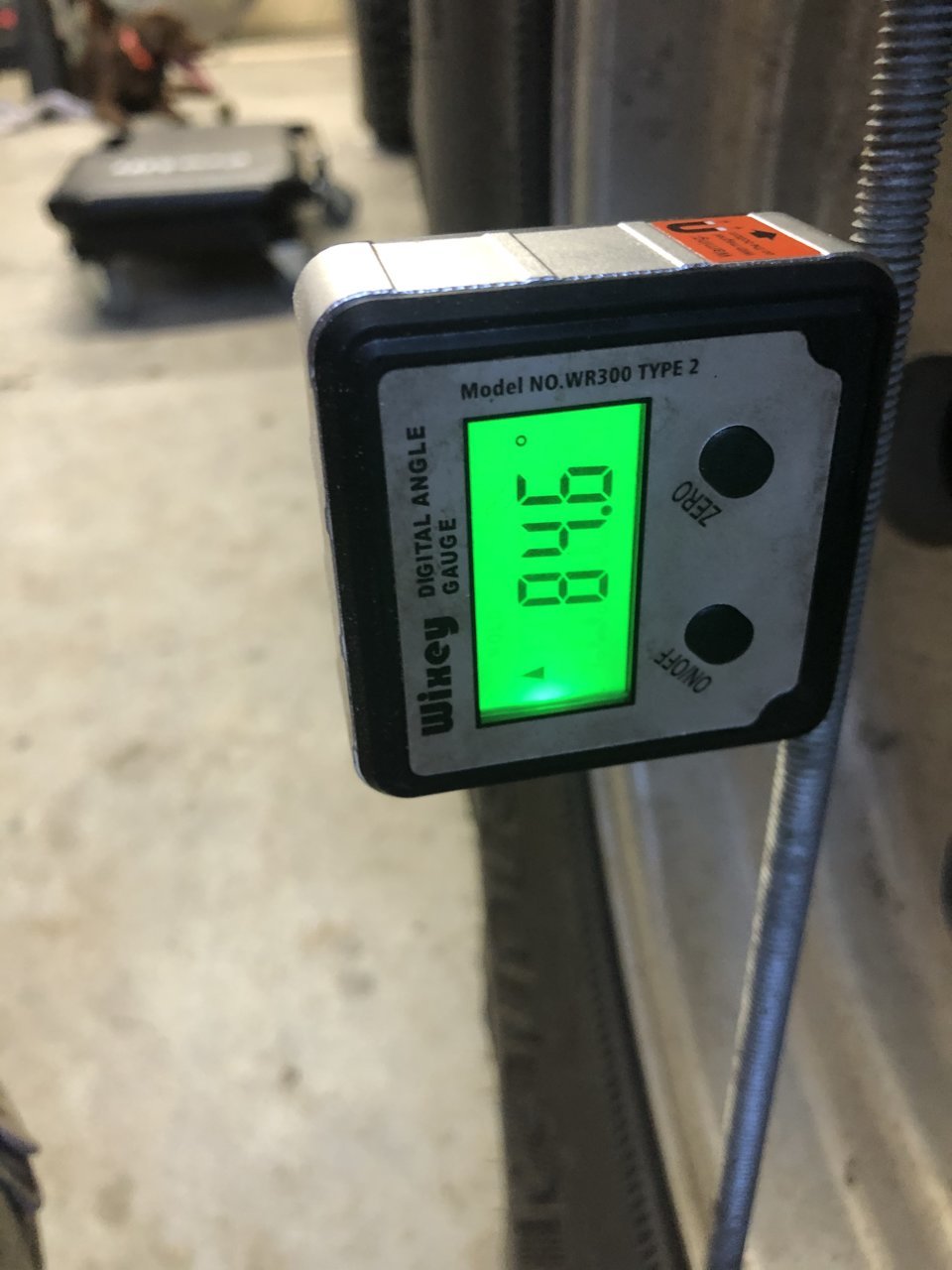

    Small update. I swapped the Hankook tires and the rims for old set I had, worn out Nitto trail grapplers and stock 16s. The bouncy has become better. However, it’s still bouncing in the same speed range. It’s harder to replicate and doesn’t do it as consistently as it does with the Hankooks, but it does still do it.
    Also, took a measurement of camber on the rear and both appear to be close.

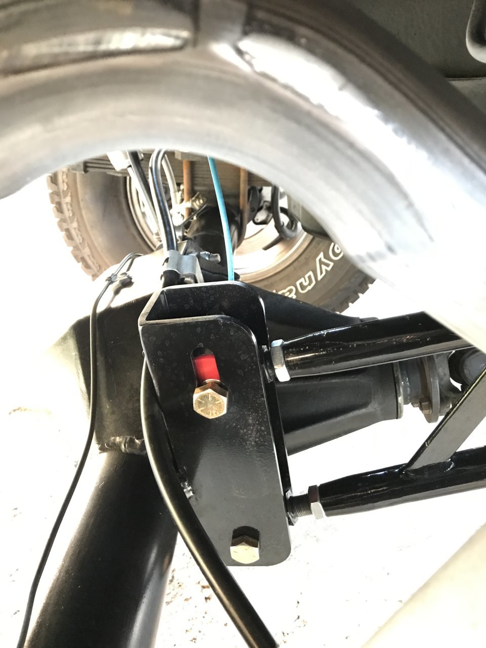

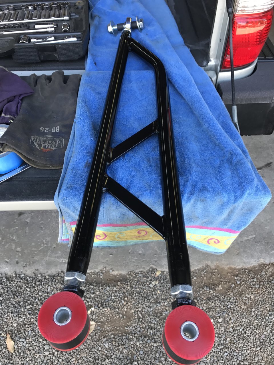

    If you're certain you have axle wrap, install a BudBuilt Trac bar.
    I went this route and all axle wrap is gone.
